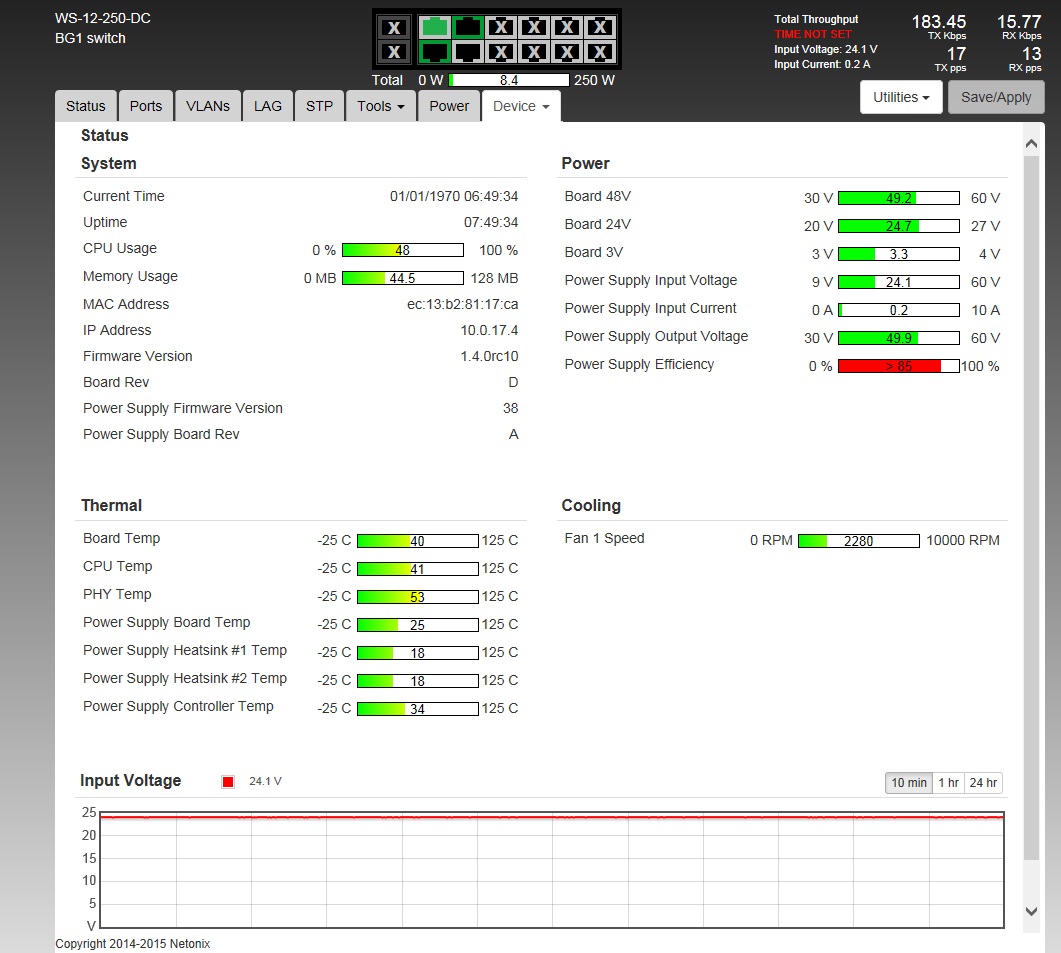

Just update my 2 WS-12-250DC and left one on the bench testing. I never saw the spurious voltage and temp noise that we were seeing in the field, when on the bench however I just checked into the switch and there was an exclamation icon and the following:-

what load do you have plugged into the switch ports that you turned on, and what is your power supply source?
these are real out of range failures, and with the code change probably not bogus, so we need to figure out whats up so
describing your setup will help.

what i meant was it might be possible that your power source in the lab has to low a current limit set on it, or possible bad connections, and if our dc-dc power supply can't get enough current it will still try & output it power to the main board, but it will not be able to keep the 48 volts at 48 volts because it is current starved so it will simply start dropping its output voltage, and that will also effect the 24 volt supply on the switch board.
that is why I am askign about your setup

Hi Dave, its a 24v SMPSU 2.5AMP. The switch has no load on it at all, just my ether cable plugged in so I can monitor.
It is configured for one of our tower sites, so a couple of the ports have POE enabled, but nothing connected. Screenshot of status page attached

thanks, i am investigating this..for sure the latest rc code has vast improvements, but it seems i have to track down some floating ghost of a bug....
dave
dave

Also be aware efficiency is so low because there is no load.
It is sort of counter intuitive that the efficiency goes up with load but it does.
