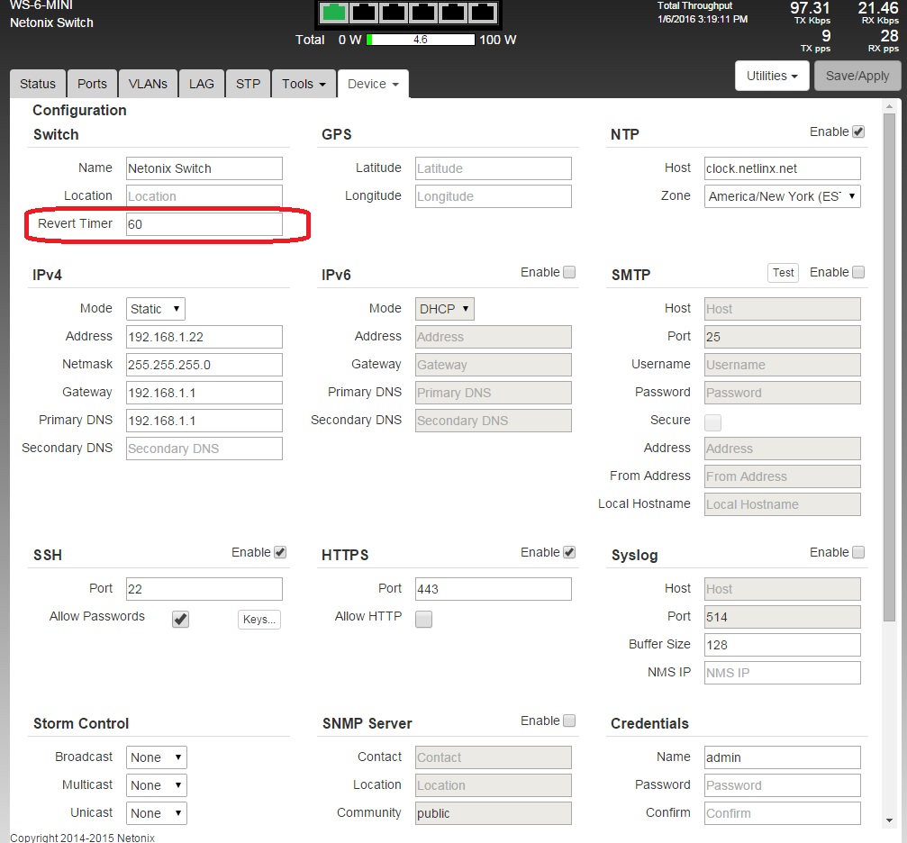

Here is the log.
Dec 31 19:12:03 STP: set port 2 to learning
Dec 31 19:12:03 STP: set port 2 to forwarding
Dec 31 20:39:13 UI: Configuration changed by 10.0.4.35
Dec 31 20:39:13 UI: IPv4_Address: changed from '10.0.4.7' to '10.0.9.7'
Dec 31 20:39:13 UI: IPv4_Gateway: changed from '10.0.4.1' to '10.0.9.1'
Dec 31 20:39:15 admin: removing lan (eth0) from firewall zone lan
Dec 31 20:39:19 admin: adding lan (eth0) to firewall zone lan
Dec 31 20:39:20 STP: set port 2 to discarding
Dec 31 20:39:23 STP: set port 2 to learning
Dec 31 20:39:23 STP: set port 2 to forwarding
Dec 31 20:40:23 admin: Reverting to last known good configuration
Dec 31 20:40:25 admin: removing lan (eth0) from firewall zone lan
Dec 31 20:40:28 admin: adding lan (eth0) to firewall zone lan
Dec 31 20:40:30 STP: set port 2 to discarding
Dec 31 20:40:33 STP: set port 2 to learning
Dec 31 20:40:33 STP: set port 2 to forwarding

If the browser you are using can not re-establish communications with the switch when you change the IP address within 60 seconds the switch will revert to the last IP address.
You either need to upgrade to v1.3.9rc12 and disable Safe Mode on the device config by setting to "0".

ok thanks for your help, i changed the time to 120 and added that subnet to my computer and it works now. The problem was by the time i changed the ip on computer it reverted back to original ip.

maxbb wrote:ok thanks for your help, i changed the time to 120 and added that subnet to my computer and it works now. The problem was by the time i changed the ip on computer it reverted back to original ip.
I just had a similar issue and fixed it by increasing the revert timer. The problem for me was that I was testing it locally and was manually changing the IP address on my secondary NIC to be on the new subnet. I guess 60 seconds wasn't enough time to do that and log back into the switch before it would kick back to the original IP.
Re: v1.3.8 FINAL bug reports and comments
Maybe on next release we will increase the default to 120 seconds?
