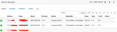

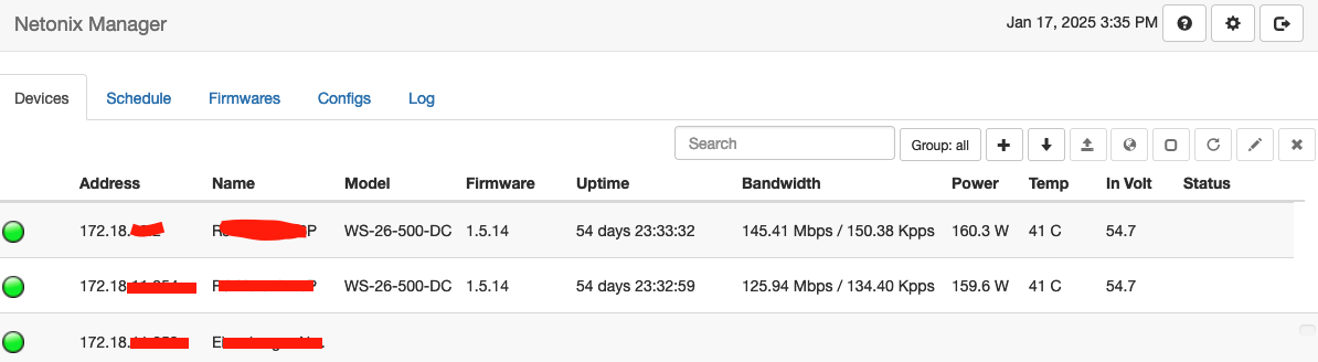

Apparently, we are encountering a very strange issue with 1.0.20 as well as 1.0.21 @Yahel have asked to post it here. We did manual upgrade of netonix manager from 1.0.20 to 1.0.21 there was a UI issue which only show 5 Netonix in the list (see screenshots) we have close to 80 of them and that seems to be persistent even after upgrade. After restart of service we see the full list but as it start getting update from netonix it again reduce to 5 only. Is this a known issue? Do you have fix?
If this is new, then We are going to a fresh install of the netonix manager on a new VM and then add all netionix again.
Thanks,

We tried installing the netonix-manager version 1.0.21 from the scratch on a new VM running Ubuntu 22.04 with nodejs version 12.22.9
But this didn't solve the issue.
To add switches I used 172.18.0.0/24 wild card discovery and this found close to 80+ switches , We noticed there were duplicate entries as manager found monitor IP's on these switches as separate device. All switches were shown for a while and then the page refreshed and Only 3 netonix stayed visible. the last one with incomplete information.

I guess I spoke to soon about it being good. Today I have just a partial list of switches - 2 complete lines and the 3rd line just has the address and name columns. Looks basically the same as the screenshot posted by Viv
On the Ubuntu server doing a "service netonix-manager restart" seems to temporarily fix the issue. After restarting the service if I load the webpage and login the list is complete. If I leave the page up it seems to remain a complete list. However, if I press the web browser refresh button or F5 or Ctrl-F5 when the page refreshes it is an incomplete list again. Sometimes showing just 2 complete rows and a partial 3rd. Sometimes showing a few more full rows. Once it has messed up logging out and logging in does not help. Only restarting the service on the server will clear it. Loading the page on a different computer once it is messed up gives the same issues.
If you logout/login several times you will eventually get the messed up display as well.

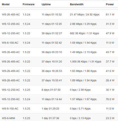

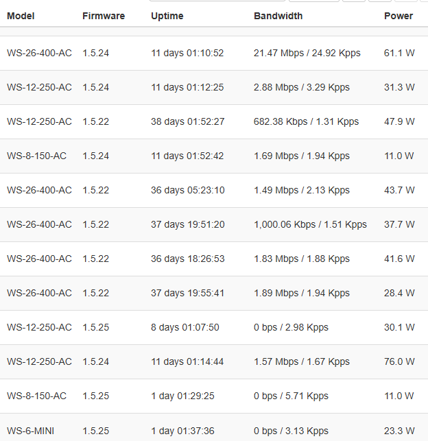

Noticed another thing with manager 1.0.21
Switches that are firmware 1.5.25 always show 0 bps in the first number in the Bandwidth column.
I cannot validate any of the values shown in the bandwidth column (I don't know if that is an average over some time, a snapshot at the last refresh, ??) but I've only seen zero in the first number for switches at 1.5.25. The 3 switches at .25 in the screenshot have 1 or more cameras on them and always have traffic.
Re: v1.5.25 Bug Reports and Comments
Yea I noticed the bandwidth column was wrong too and totally forgot to mention to Stephen.
We are testing a new version right now again didn't check that column.
I'll ping Stephen on this.
That column should report TOTAL bandwidth. Not sure when that changed.
