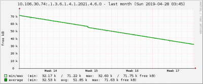

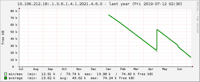

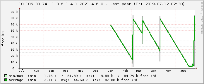

I don't think our network is somehow non-standard. In this case it is a mikrotik as the main router (uplink is directly on its port), on the second port is netonix switch.
There are 5 Ubiquiti Rocket 5AC-PRISM Gen2 access points (firmware 8.5.8) in the switch and one Siklu 710TX. It's not part of a large L2 domain (the MAC table has 181 records), our network is routed. But every UBNT has its own VLAN, which is then part of the bridge in the mikrotik. DHCP snooping is on.
I do not use STP, MSTP, LAG, ERPS, IGMP snooping.
Client radios are in bridge mode, mostly TP-LINK wifi routers at home. Sometimes mikrotik.
We do not use IPv6 for radio clients. The router has IPv6 enabled, but does not route. So it only has link-local addresses.
Management uses SNMP (I have both versions turned on), once a day ssh.
I tried to turn off the discovery on another piece, it didn't have a significant effect.
A detailed process dump might be a good idea. It just means about a month waiting for the result.
Where I watch free RAM, SNMP is used very often.
https://forum.netonix.com/viewtopic.php?f=17&t=5384But on switch where I don't have RAM problem (resp. usage grow slower) has this log file 30MB.

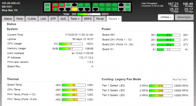

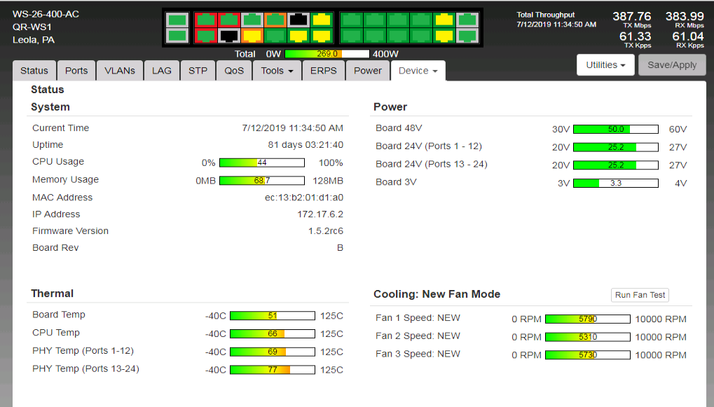

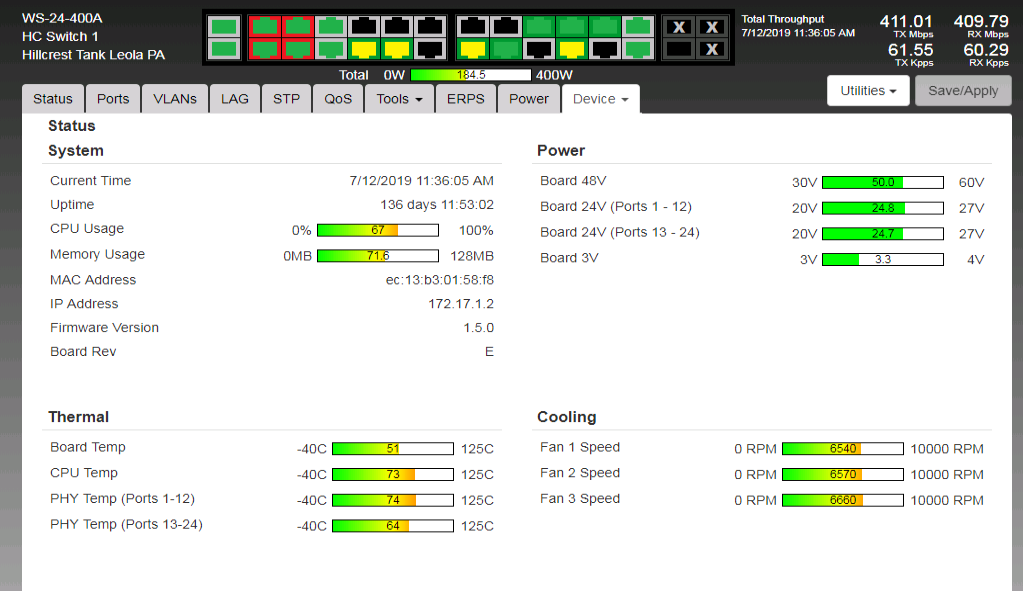

Why are you not using v1.5.2 or v1.5.3rcX which helps the developers as your seeing an issue on a thread of code in development
But I still do not see this memory usage issue on any of my switches in my WISP, see below.

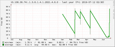

You are lucky man ... i have problem (sometimes smaller, sometimes bigger) with ALL OF NETONIX. But I don't have WS-24/26, only WS-12 and smaller.
Software version doesn't matter! 1.5.2rc6 is same as 1.5.2.
I can't experiment on a network with hundreds of users. You have a software problem. I have the right to buy a functional switch from you. If you're not going to do anything about it, tell it in time. I move to a different supplier to prevent major financial losses. I don't like it anymore.

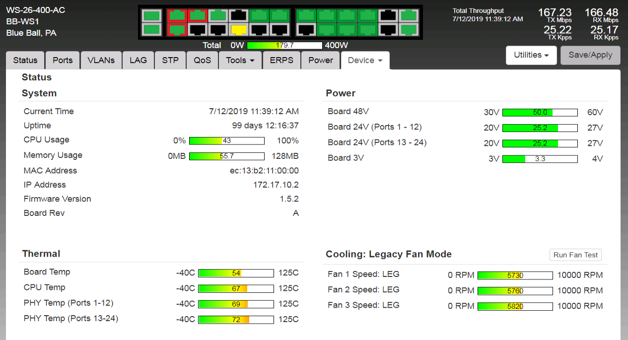

All the switches are the same, same SOC, same basic design, same firmware. I have just about all models running in my WISP and do not see the memory issue. Has to be something different about your setup then most people as there are tens of thousands of these out there running with no issue.
There have been about 4 or 6 people who have run into this memory issue and we have no idea why and can not recreate it.
If you want to assist us then load the latest firmware and make the switch accessible to our programmers (Stephen or Eric) and then maybe they can see what is causing this for you and few other people.
It helps to try and narrow it down.
Disable everything (services) that you can on the switch and see if the issue still occurs.
-SNMP
-NTP
-SMTP
-STP/RSTP/MSTP
-Loop Protection
-Discovery
-Radius
-Everything you can
If the memory issue does not occur then enable services one at a time and try and narrow it down.

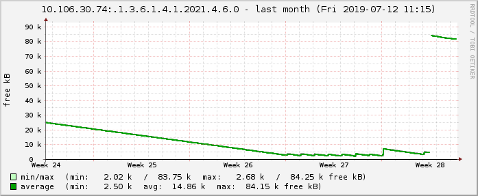

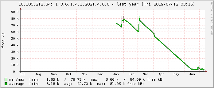

This snmp query (get .1.3.6.1.4.1.2021.4.6.0, not walk!) is for graphing memory usage ... and graphing is as proof for you :-( Memory problem is not based on this.
I started using this OID only after I discovered a memory usage problem.
But you must resolve this :-) Disabling logging, or logrotate, or something else ...

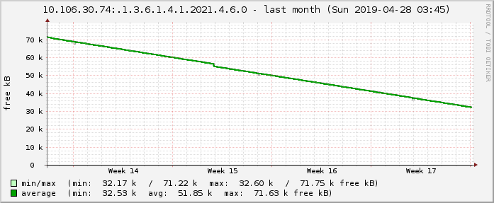

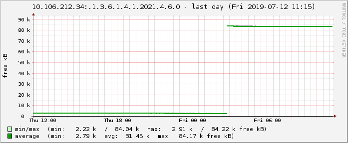

Ludvick, I have a new test firmware I'd like you to try. You may still use the OID you are using. I have run some test's and I was able to replicate a memory leak and the change's I made seemed to fix it. But obviously, we need to run a long term test on your network to be sure.
May I PM you the firmware?
