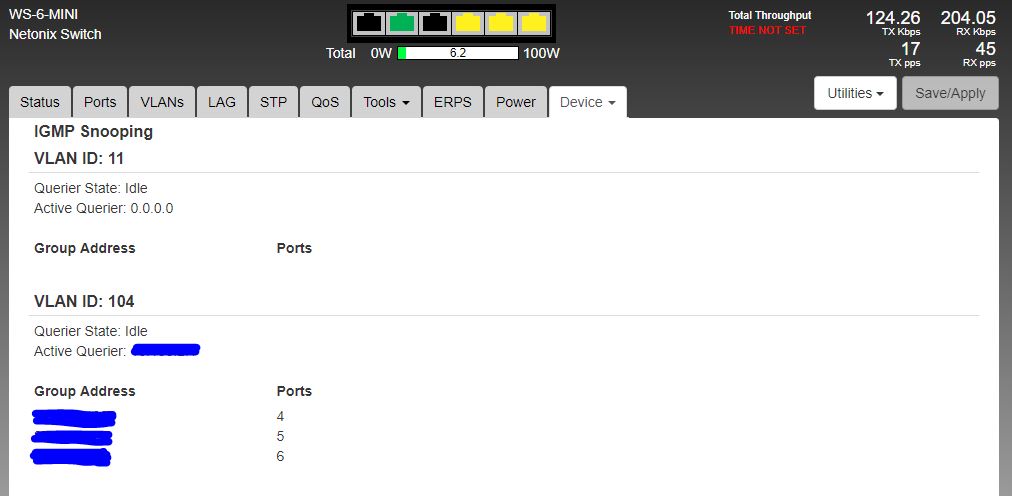

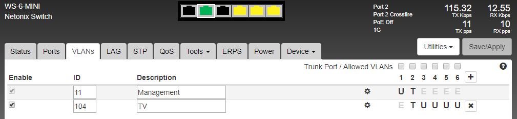

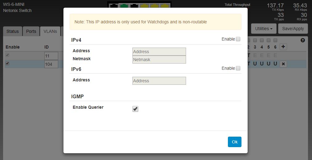

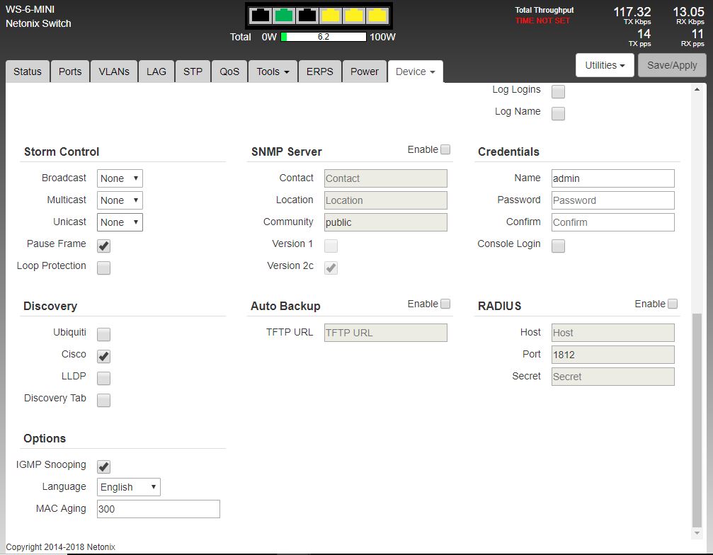

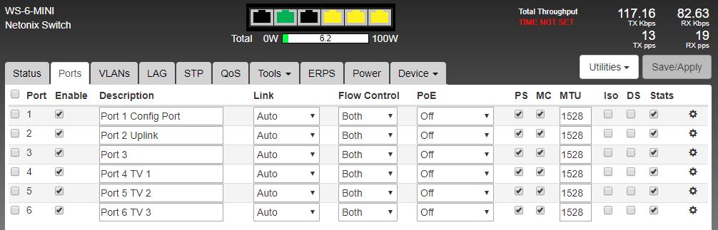

Querier is not working with this test configuration. Please let me know if there is some configuration here that is missing. I'd like to help accelerate the process, feel free to contact me directly.
Notes:
  • When disabling the querier, it doesn't always fully disable until a reboot. Multicast traffic sometimes will not start again until reboot.
  • When enabling the querier, it lists the management address (on a different VLAN) as the "Active Querier" which is incorrect.
  • When disabling the querier without reboot, sometimes it lists the correct IP of the querier on the correct VLAN... until reboot.
Port Config, MC is enabled on every port
VLAN Config, VLAN 104 is for Multicast
VLAN Config for VLAN 104
Querier Enabled
IGMP Querier Tab

You need to assign the VLAN an IP address (in the subnet the clients are using) if you are going to enable the querier on it, otherwise it will use the management IP address as you saw.
