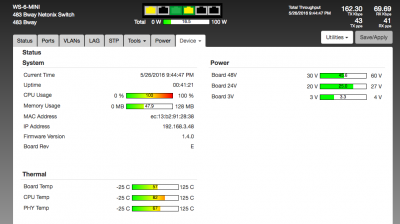

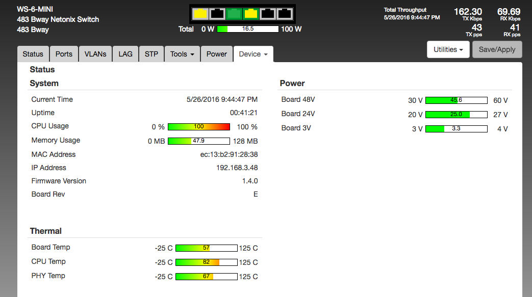

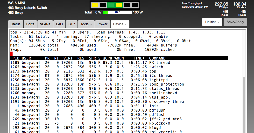

Copying this over from my other thread...
Have a WS-6-Mini that flipped out today while running 1.4.0rc25. Saw uplink port drop a few times, then the switch rebooted. It's now running at 100% CPU with most of the usage from a process called "RX Thread".
There's very little traffic on this thing. The most complex thing happening here is allowing tagged vlan 101 in one port and out another.
Port stats:
Code: Select all
bwayadmin@483_Bway_Netonix_Switch:/www# switch -d
Port 1: link 100M-F, poe Off, power 0.0, tx_pkts 105388, tx_octets 36792207, tx_errors 0, rx_pk
ts 79664, rx_octets 23351507, rx_errors 0
Port 2: link Down, poe Off, power 0.0, tx_pkts 0, tx_octets 0, tx_errors 0, rx_pkts 0, rx_octet
s 0, rx_errors 0
Port 3: link 1G, poe 24V, power 0.0, tx_pkts 68638, tx_octets 20769806, tx_errors 0, rx_pkts 91
912, rx_octets 25981625, rx_errors 0
Port 4: link 100M-F, poe 24V, power 0.0, tx_pkts 7548, tx_octets 1768414, tx_errors 0, rx_pkts
4844, rx_octets 827677, rx_errors 0
Port 5: link Down, poe Off, power 0.0, tx_pkts 0, tx_octets 0, tx_errors 0, rx_pkts 0, rx_octet
s 0, rx_errors 0
Port 6: link Down, poe Off, power 0.0, tx_pkts 0, tx_octets 0, tx_errors 0, rx_pkts 0, rx_octet
s 0, rx_errors 0
status screen
top
