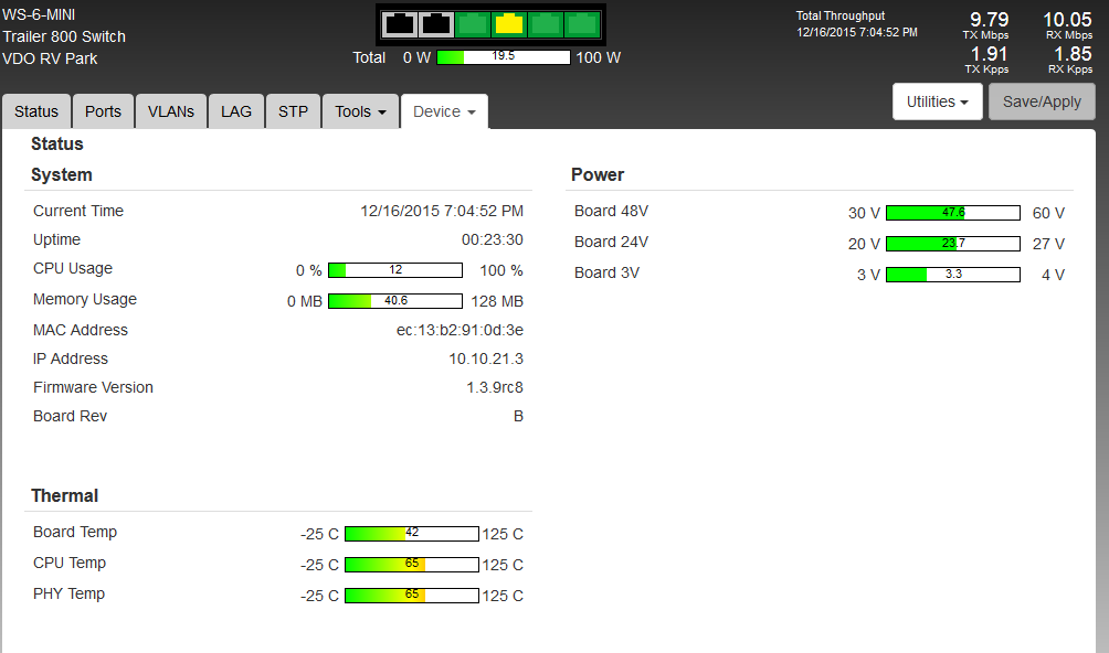

I upgraded a WS-6-MINI to 1.3.9rc8. I upgraded it from the standard to the RC because I was seeing a high CPU load and having SNMP failures. I now have 99% CPU load when I have SNMP enabled that does not go away without SNMP disabled and the switch rebooted. I have attached a screenshot of the switch with SNMP disabled.
Trailer 800 Switch# show status
System
Current Time: 12/16/2015 18:34:27
Uptime: 593.469971 seconds
CPU Usage: 99%
Memory Usage: 45.32 MB
MAC Address: ec:13:b2:91:0d:3e
IP Address: 10.10.21.3
IPv6 Address: fe80::ee13:b2ff:fe91:d3e
Firmware Version: 1.3.9rc8
Model: WS-6-MINI
Board Rev: B
Power
Board 48V: 47.6 V
Board 24V: 23.7 V
Board 3V: 3.3 V
Thermal
Board Temp: 43 C
CPU Temp: 67 C
PHY Temp: 68 C
Cooling
Can I downgrade back to the standard release without loosing my configuration?
CPU between 10 and 15% with SNMP disabled
Switch with SNMP disabled.PNG (32.34 KiB) Viewed 26679 times

Re: v1.3.9rcX - BETA/Release Candidate
Wed Dec 16, 2015 9:53 pm
gilljr wrote:I upgraded a WS-6-MINI to 1.3.9rc8. I upgraded it from the standard to the RC because I was seeing a high CPU load and having SNMP failures. I now have 99% CPU load when I have SNMP enabled that does not go away without SNMP disabled and the switch rebooted.
Yes you can downgrade to v1.3.8 but this does not make sense. I would re install the v1.3.9rc8 and then "power cycle" it. Make sure to leave power off for at least 5 seconds or it could boot funny as it did not have time to power down completely.
Thu Dec 17, 2015 11:48 am
v1.3.9rc8/WS-6-MINI
I am only querying the switch with SNMP; not using TRAPs or using syslog so I do not believe the bug mentioned in the topic above is it. I have attached my configuration below to see if something maybe stands out to you. I will be reloading the software and then performing a hard reboot later today to see if maybe it was only a bad load as you mentioned to be a possibility last night.
Gilbert

Thu Dec 17, 2015 6:36 pm
We reloaded and then rebooted. The SNMP CPU issue went away so it must have been a bad load. Thanks for the help. The only issue I see at this point is that port 1 has a link light on it with nothing plugged in and no power applied to the port. I have attached an image.

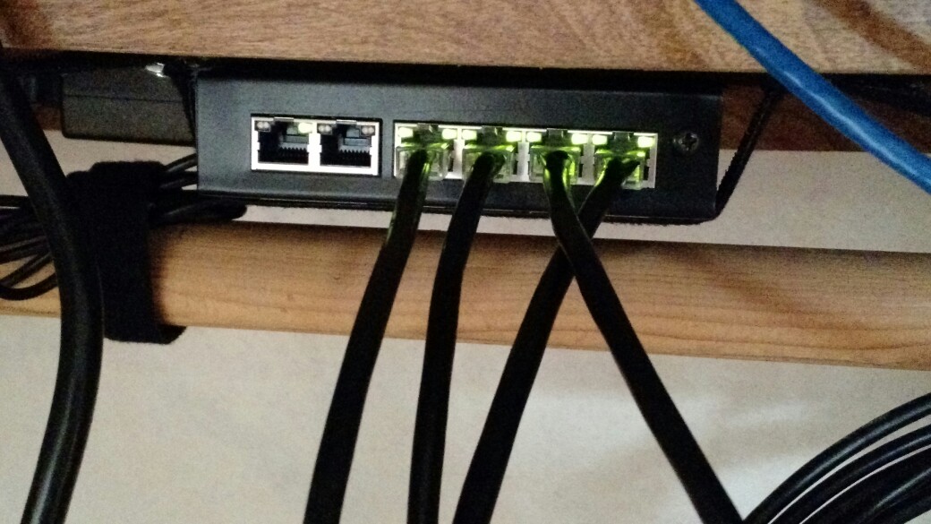

Port one shows a light with nothing attached
trailer 800 post cable.jpg (142.23 KiB) Viewed 26658 times
