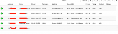

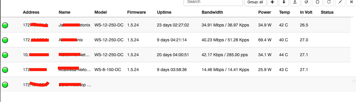

Apparently, we are encountering a very strange issue with 1.0.20 as well as 1.0.21 @Yahel have asked to post it here. We did manual upgrade of netonix manager from 1.0.20 to 1.0.21 there was a UI issue which only show 5 Netonix in the list (see screenshots) we have close to 80 of them and that seems to be persistent even after upgrade. After restart of service we see the full list but as it start getting update from netonix it again reduce to 5 only. Is this a known issue? Do you have fix?
If this is new, then We are going to a fresh install of the netonix manager on a new VM and then add all netionix again.
Thanks,
Thanks,
Re: v1.5.25 Bug Reports and Comments
Can anyone else confirm the above issue or state they do not see the issue.
If multiple people see this issue i will move it up on list.
Please report info such as windows or Linux flavor, OS version, number of switches in manager, all updated to v1.5 25 or mixed (why as v 1.5.25 is best vetsion) and so on.

What ranges of firmware are you using?
If a wild mix possibly try upgrading all to v1.5.25 (best firmware we have)
If all are v1.5.22 or higher then possibly you have corrupted install or config which may require removing all files and re-install from scratch?
