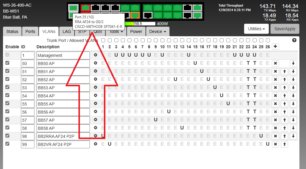

We do report what the SFP module reports as the vendor, simply mouse over the SFP port and a box pops up and we provide everything the control module reports.
I think we could query "optical" SFP modules for that info (some as not all report properly / follow spec). I will suggest doing that in the WS3 line then possibly back port it to the WS line.
And when I say some, we have several 10G SFP modules that report incorrect info, even as far as fiber reporting as copper and copper reporting as fiber. Cisco "always" follows spec and you pay dearly for it. $$$$
When you buy based on $$$ it's a crap roll.
