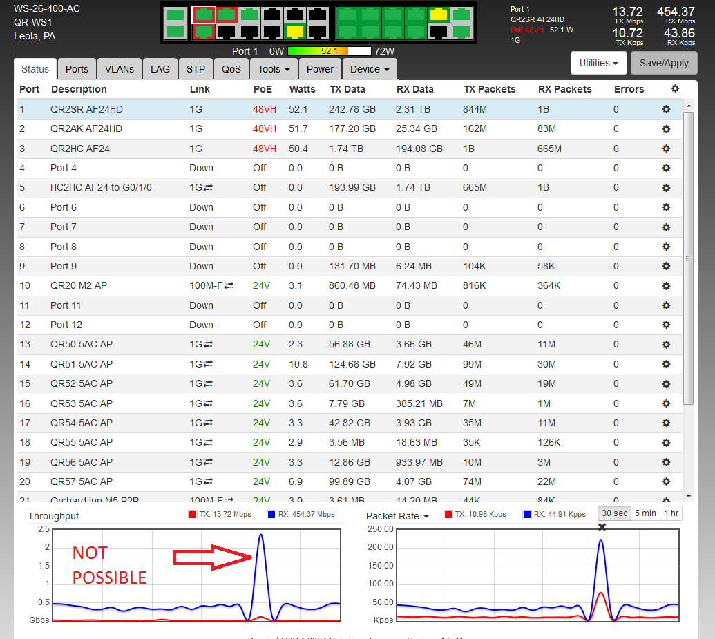

Good news is we are 99.9% sure we know what this is and Stephen has family issues today but will be working on it tonight provided his 3 year old daughter cooperates.
I know you said this bug started around 1.5.16 but in reality it has been around since the inception but only became more noticeable the more features we added.
To make a long story short its all about timing. We tell the switch to take readings every second or so it's supposed to. But graphing is a LOW priority service and sometimes the switch gets busy with higher priority stuff like STP, LACP, and so on delaying the readings. When the reading gets reported we just assumed 1 second since last reading but if delayed say 3 seconds then it averages out the reading based on 1 second. This anomaly shows up in all graphs as seen in picture below.
But like I said we are 99% sure we know what it is and how to fix it but nothing is guaranteed until you implement and test.
