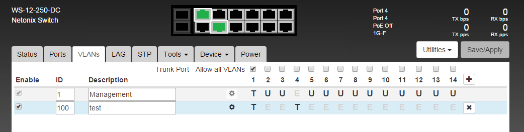

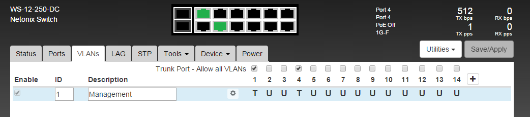

Re: Bug Report: Deleting a VLAN disables trunking for vlan
keefe007 wrote:I have recently discovered a bug in 1.2 related to VLAN. If I add a VLAN to a switch and then remove it later the switch will no longer trunk that VLAN. It explicitly denies trunking the deleted vlan but continues trunking all other VLANs as normal.
This could become a big problem as people might temporarily setup access ports to do testing and then remove them--and break their trunking of that vlan.
Keefe
I was unable to duplicate this bug in the lab today with 1.2.1.
I have a device on Port 4 using VLAN ID 100. Port 1 is hooked up to another switch which has another device that is also on VLAN 100. I have an explicit VLAN configured for this. The two devices can ping each other.
I then removed the explicit VLAN and trunked Port 4. After doing this the two devices can still ping each other.
