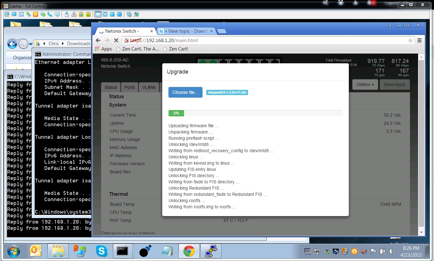

I have tested the upgrade from v1.1.8 to v1.2.0rcX before with no issue but I am doing it again to verify.
I downgraded switch to v1.1.8 and now I am upgrading it.

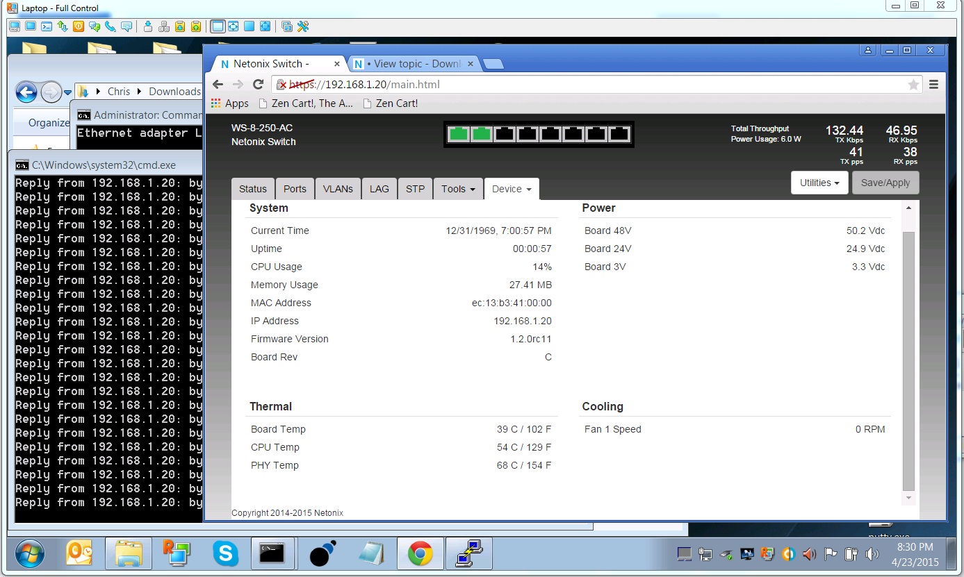

Went through smooth?
Let me know what you find.

Upgradet all my WS-8-250-AC from 1.1.8 to v1.2.0rc11, All OK no problems :o)
