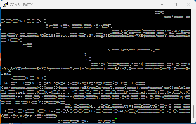

I have tried to use the recovery tool on several switches lately and the result is always the same. The tool never stops running (even though it shows 100%) and the switch displays jiberish when I connect to it with putty after a reboot. See attachment.
Re: RECOVERY TOOL VIA SERIAL FOR SWITCHES
dan@e-co-op.com wrote:I have tried to use the recovery tool on several switches lately and the result is always the same. The tool never stops running (even though it shows 100%) and the switch displays jiberish when I connect to it with putty after a reboot. See attachment.
If your have your terminal emulator setup correctly i.e. speed and such and your serial cable is not faulty and you still get gibberish then the serial port /console interface is damaged.
You can send the unit in for repair even if it is out of warranty as our RMA portal http://rma.netonix.com now accepts RMAs on older units for REPAIR with WISP Repair. You can also use our RMA portal to get RMA REPAIRs for other vendors with WISP Repair (NOT NETONIX).
Netonix now only repairs defective units within warranty period but the RMA portal will allow you to create and RMA REPAIR with WISP Repair.
Thanks sirhc!
I have a working unit right next to the faulty one and my serial connection works fine with it so that's not an issue. This symptom was the result of a power failure at the tower site and when power was restored the unit restored and worked fine for about 30 minutes then became unresponsive. I assumed it had gotten corrupt and needed reloaded but I have been unable to get it to reload. It just seems odd that almost every time I have a unit that is unresponsive the Serial tool doesn't work either.
Anyway, I'll move on. Thanks for your time and insight!
