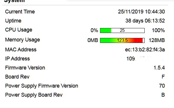

1.5.4 mem leak, fixed 1.5.5 ?
Had a creeping memory leak problem with 1.5.4 here which results in a load of problems with traffic once it runs out of ram.
A reboot of the switch resolves it again.
We thought 1.5.4 had resolved this from 1.5.2 , is there a service we need to disable that is behind the memory leak?
Does 1.5.5 resolve it as i cannot see a mention in the documentation.
Also could a watchdog option be added that reboots the switch if it is close to running out of ram? Not ideal but far better than finding out after it has been dropping traffic on/off for hours.
The switch is a WS-12-250-DC
Bill

Re: v1.5.5 Bug Reports and Comments
amojak,
It would be worth updating to 1.5.5 to check. Some of the fixes where very subtle and could easily have resulted in several different issue's. The one's listed are just the one's that where identified to be the result's of the issue's in <1.5.5
If you still see something strange. It might be worth disabling STP to check if that fixes the issue. There have been some report's that indicate it could be responsible for leaking in certain network topology's.
- amojak
- Posts: 3
- Joined: Mon Nov 12, 2018 10:12 am
hi,
I took as look at other netonix switches we have running and the ones that do not exhibit this issue had LLDP turned off, this one had it on for some unknown reason.
So have turned it off and upgraded to 1.5.5.
The other odd issue i have with this switch which may be indicative of a fault or possibly a cable issue is when you reboot or upgrade it, port 1 does not come back up properly.
This leaves the power side working but no data link at all. If you change a parameter on the port and apply it then off it goes and negotiates gigabit without issue.
The cable from it is only about 4 meters long and drives a Ubiquiti prismstation AC, as do 4 other ports on the same switch.
I am thinking that for some reason Port 1 is not being set up properly at boot time, perhaps this could be looked into there? This behaviour was seen with 1.5.2 too.
The only reason of course we see it on this switch, apart from the fact it uses port 1, is due to the memory leak issue which means we have to reboot it more often, which shows the port 1 initialisation issue.
