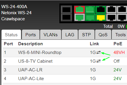

UniFi switches have flow control but not their APs. You can see on the Status tab, that devices with flow control show a double arrow.
