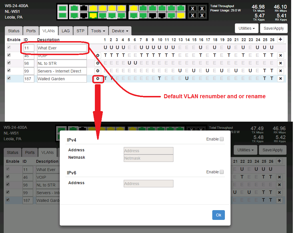

Sneak Peak
Here shows the re-number and re-name of default VLAN
It also shows you can assign a separate IP for each VLAN
Yet to finish what you guys call "trunking" - Monday maybe
Also isolated ports is coming.
CLICK IMAGE TO SHOW FULL SIZE
