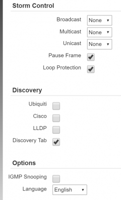

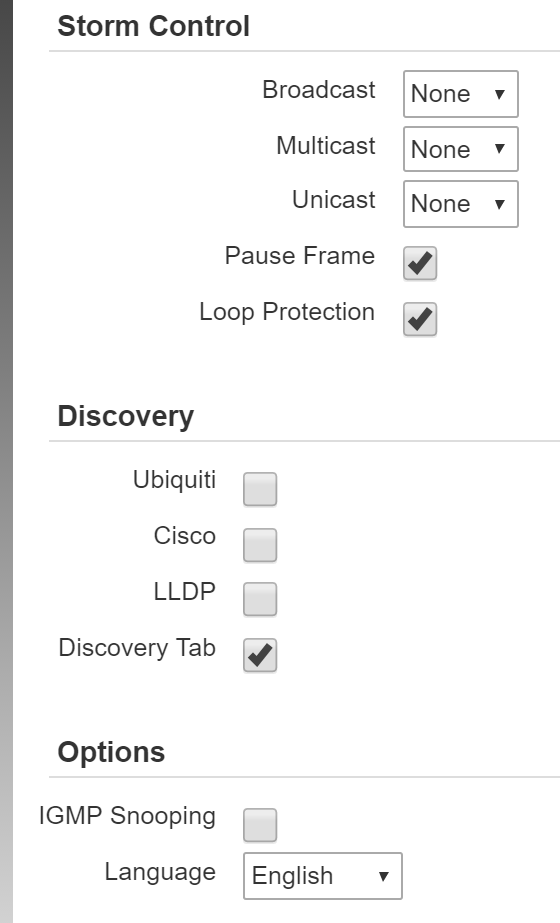

So, we have some Metrolinq's and for some reason from time to time we see all traffic get blocked but we can still get to the radios interfaces.
This makes me thing something somewhere is blocking VLAN traffic, but not the native vlan.
Does this sound like something that could be this switch bug? (the metrolinq have their share of bugs and things, but this one is weird, as we can still get to the interfaces, but all VLAN traffic is stopped for a period of 30 seconds to a minute. But it may actually be all traffic AFTER the slave radio is stopped as we do loose access to some things downstream on native vlan. We sometimes reboot the radio to awaken the path, not sure that is actually helping, as the last time, we had traffic stop, then we rebooted radio, it was still stopped, then started after about 30 seconds of the interface of both ends of the radios coming up.
nothing interesting in the logs of the SW other than some DHCP and ports going up and down when we reboot.
We are running 1.4.2rc6 WS-12-250-AC Rev D
do we need to switch off the discovery tab? here is the setup:
