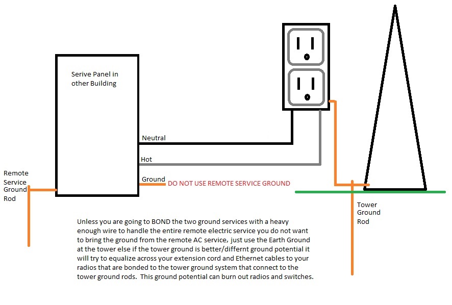

Only other thing I can think of is your running an AC extension cord over from some other power source with a differnt Garth Ground potential and whatever you are mounting the radios on has a different Earth Ground System which can be bad because if the tower has a better ground rod system then the other building would try and get to the ground of the tower through the switch and radios?
What type of tower is this and does it have its own grounding system which is differnt from where you are getting electric from?
- Been thanked: 1362 times
Re: WS-6-MINI Keeps crashing/rebooting?
When you draw power from another electric service that does not have its Earth Ground bonded to the tower ground system your mounting on you only want the HOT (WHITE) and NEUTRAL (BLACK) wire and then you use the ground from your tower.

I replaced the switch and power supply with new ones and the new switch kept rebooting about every 10-15 minutes.
I then called Sirhc and he told me to separate the power ground from the tower ground as recommended 2 post earlier. I did that but the replacement switch rebooted as well.
What is actually happening is the switch becomes unresponsive, but the APs powered by the switch keep working but with no ethernet link. Then after a few more minutes the whole switch reboots.
Any way I went ahead and put another new switch in place (one that was not connected to the tower when the Switch power supply was connected to the AC ground). So far it has not rebooted in 1hr and 6 minutes. The Board 24V/3V readings are also more stable at a constant 24.3-24.4 V and 3.3V where before I seem to recall it was anywhere from 23-25 V and 3.3-3.5V. However, the previous switch worked for 22 hours yesterday with no issue so I need to have no unplanned reboots for at least 48-72 hours before I call this issue resolved.
Also the CPU temp is around 90C and the board temp around 63C. Should I be concerned could heat be a culprit as this issue did not happen yesterday after 5pm and was good tiil around 2pm the next day. Today was much hotter in the afternoon than yesterday.

I would test all the port POE options then test each port to achieve 1G and if it runs fine in office it is OK.
Temperature "could" still be the culprit but my bet is on the fact that your service ground was different then the tower ground.
Doing what I illustrated in the above picture is what you should do. You of course should also run a dedicated ground wire with a ground bus and ground wire to each radio mount. - Just saying!!!

People discount what ground potential difference can do as far as damage and poor grounding without a dedicated ground path that is shorter and less resistant than your Ethernet cable.
There is a reason cell towers put so much money into grounding systems is they realize the savings in the long run and less down time with GOOD grounding.
