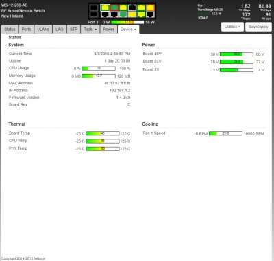

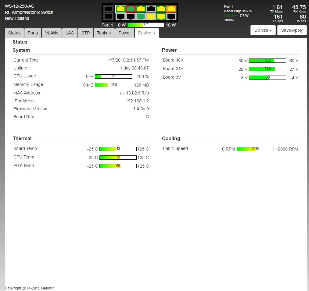

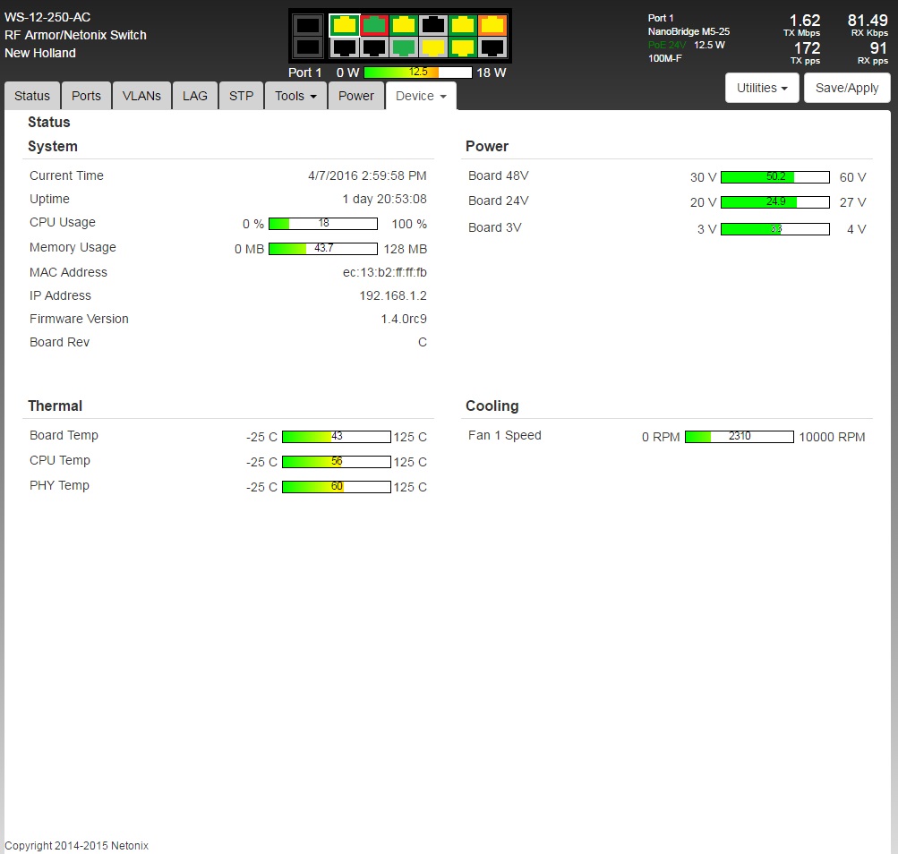

Another strange thing - since upgrade WS-12-250-AC to 1.4.0rc9 I can see in Device/Status fan speed mostly at max (9000-10000rpm), with 1.3.9 mostly stable at 7000rpm. Are there any changes there?
Re: v1.4.0rcX Bug reports and comments
Thu Apr 07, 2016 2:59 pm
Mine does not?
Put up a screen grab.
Thu Apr 07, 2016 3:01 pm
I sat here and watched mine and it just dropped.
