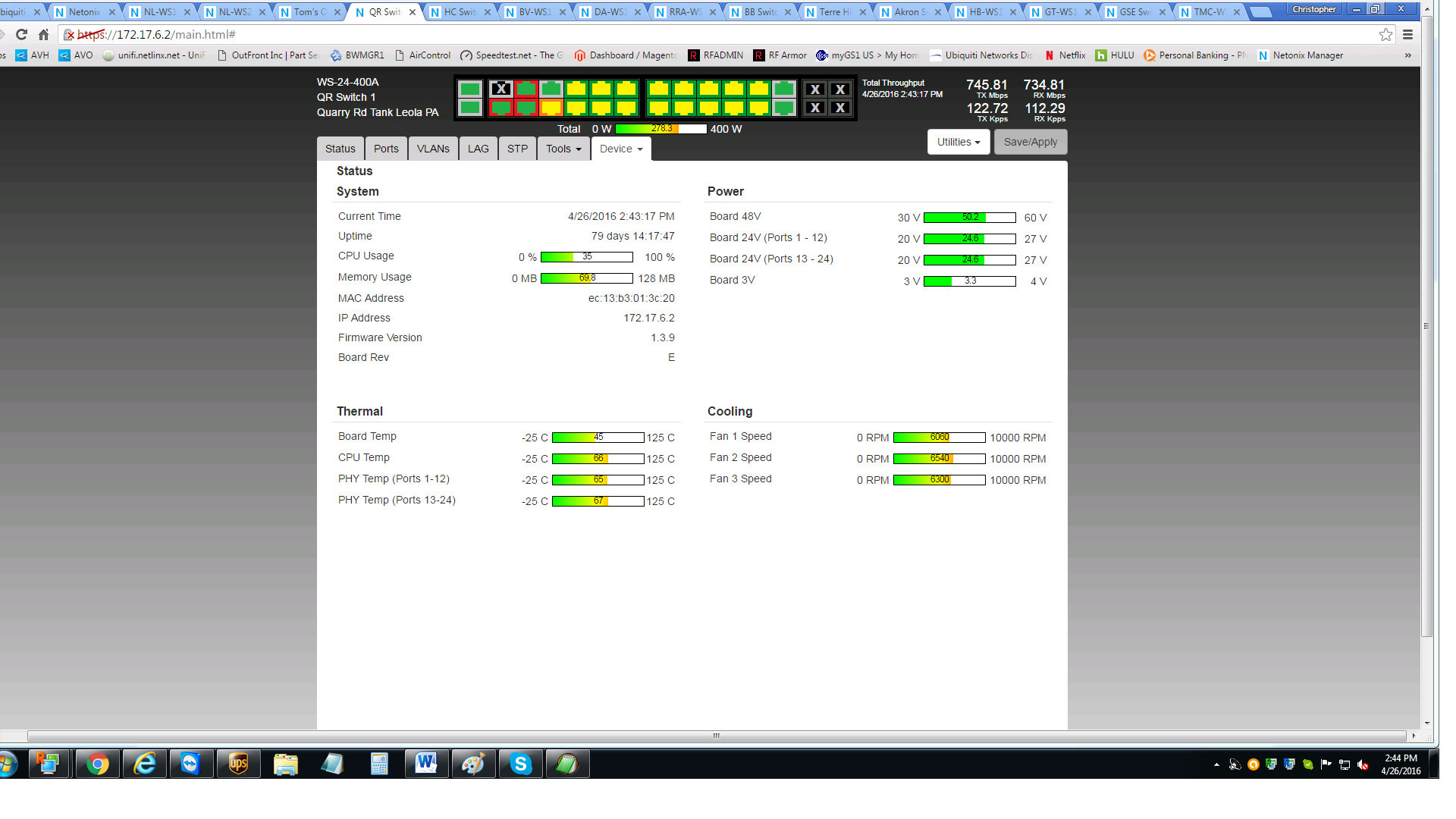

The web UI locking up, becoming unresponsive, or displaying a blank page hit me again today on a WS-24-400A switch running 1.3.9 (release) with an uptime of 83 days 6 hours. The switch was pingable, so I used SSH to connect to it. Nothing showed in any longs. I restarted the lighttpd process and the web UI became responsive. For a short time. I made a configuration change (VLANS and/or power on a port) and applied it. That worked. But when I attempted to apply another change, it took forever--never applied--logs showed nothing--and I had to restart lighttpd again. This sequence of first config change applies erratically but second change locks up the web UI happened 2-3 more times. Then I discovered that if I killed the php-fcgi process AND restarted lighttpd, things began working again.
