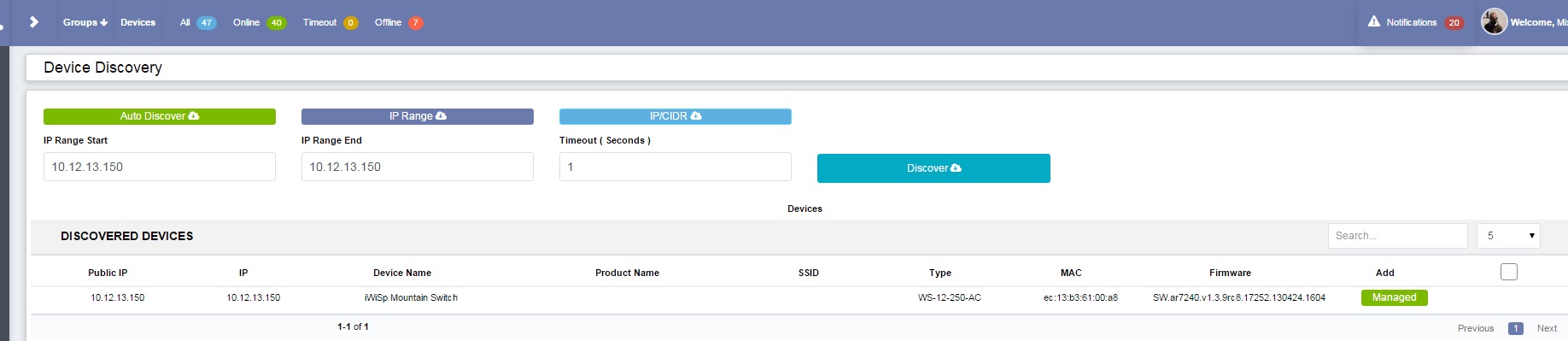

- Fixed UBNT Discovery name

Chris & Eric the last F/W (1.3.9rc8)
fixed the issue with discovery and device name.
Thank you for the fast fix (less than 3 days after initial report!!!)

Updated mine this morning, they are fixed also. Thanks for getting to this so quickly.
