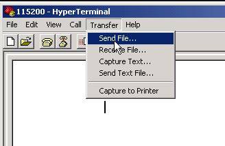

cable guy wrote:No it did not prompt me for a folder location
Did you click Transfer -> Send File in HyperTerm ?

thanks Jakematic, I do not have hyperterminal on windows 7, using Tera Term, used transfer xmodem send, selected file

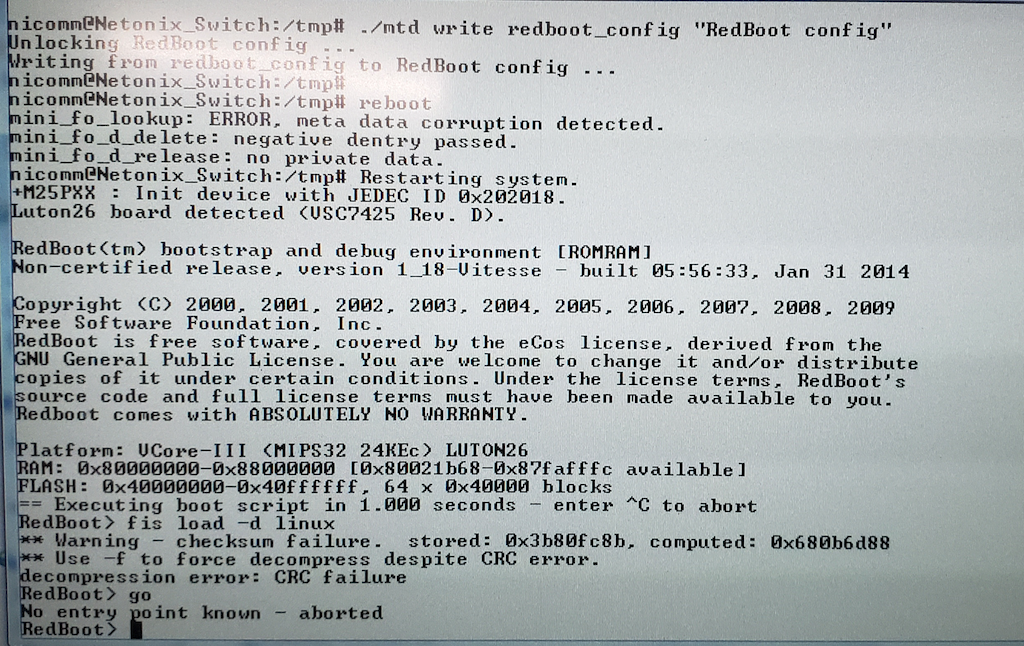

After 3 tries to do a console port recovery on WS-12-250-AC, it is still inoperative - checksum failure
attached is the screen shot after reboot
Do I ask for an RMA at this point ?
