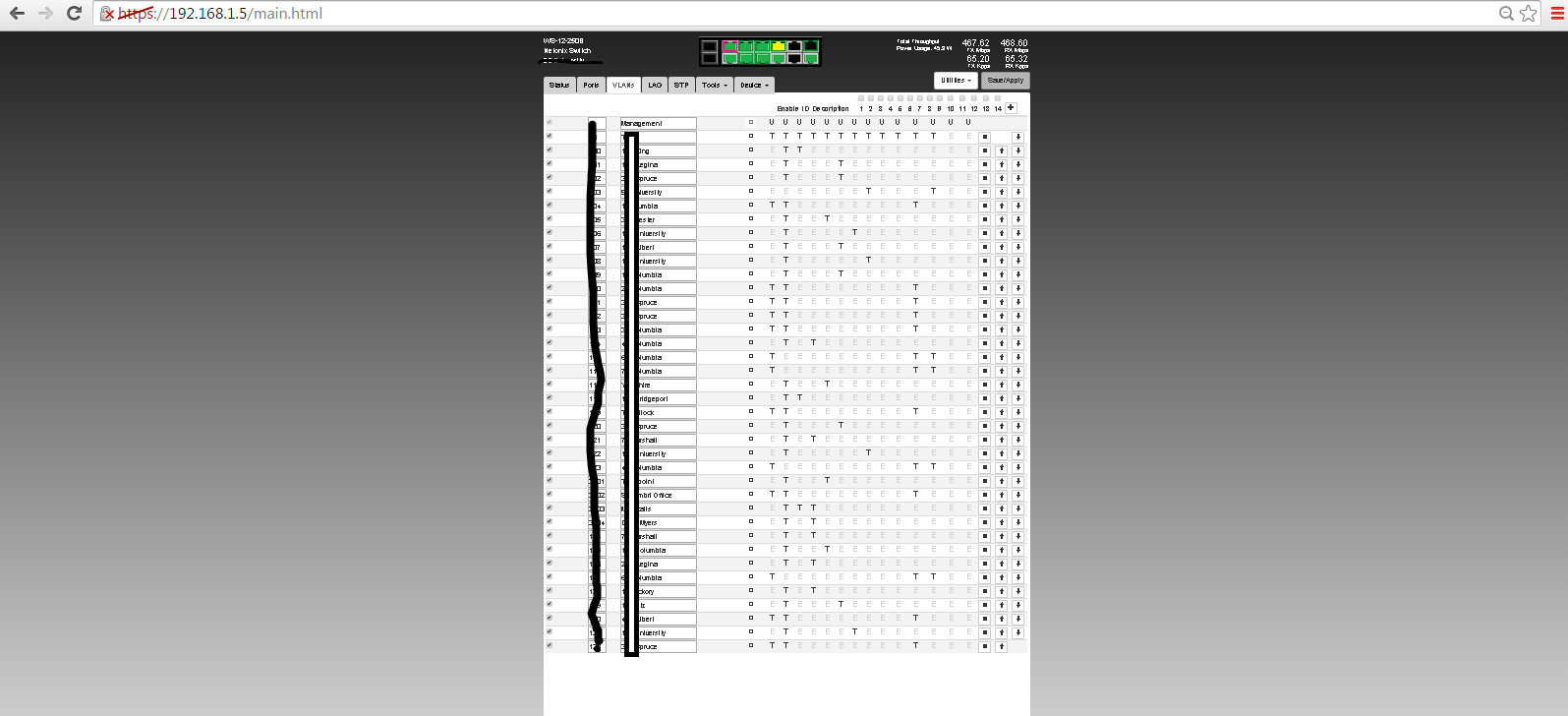

Here is the VLAN page on the switch. so what we did was exempt vlan115 from port2 and tagged it on port12. what we saw was that a mac which previously existed on port2 still showed on mac table. Fine no big deal, except that we have a new mac which uses the same IP address as the mac which shows on the exempted port. So our communication was broken until we went and unplugged the router from port2 on netonix. once we did that, the mac address cleared from the mac table and all communications was restored to the alternate mac on the same ip.
I thought that after 15 minutes the switch would learn that there are not mac addresses on port2 in vlan115, but that was not the case. It didn't learn that there was no macs on port2 vlan115 until we went onto the device plugged into port2 vlan115 and disabled it there.
Now its probably worth nothing that this device has a mac on port2 in the management vlan which works.
Also worth noting that ignore the ascii drawing about the router ports and vlans above, it does not relate to this vlan tab config.

OK, how is the VLAN tab screen grab going to help us since you crossed everything out?
The VLAN Description is just for reference and has no security risk to give out as it is JUST FOR REFERENCE PURPOSES
To some very limited risk I suppose the VLAN ID "might" be used against you but I highly doubt it.
I put up my VLAN information and so has countless others. If you want to see my VLAN IDs they are in the 1 hour movie on YouTube https://www.youtube.com/watch?v=8JvBEAD4MFM
And here in this post viewtopic.php?f=30&t=452
And here in this post viewtopic.php?f=17&t=237
Also use Paint or something and trim it down, like this:

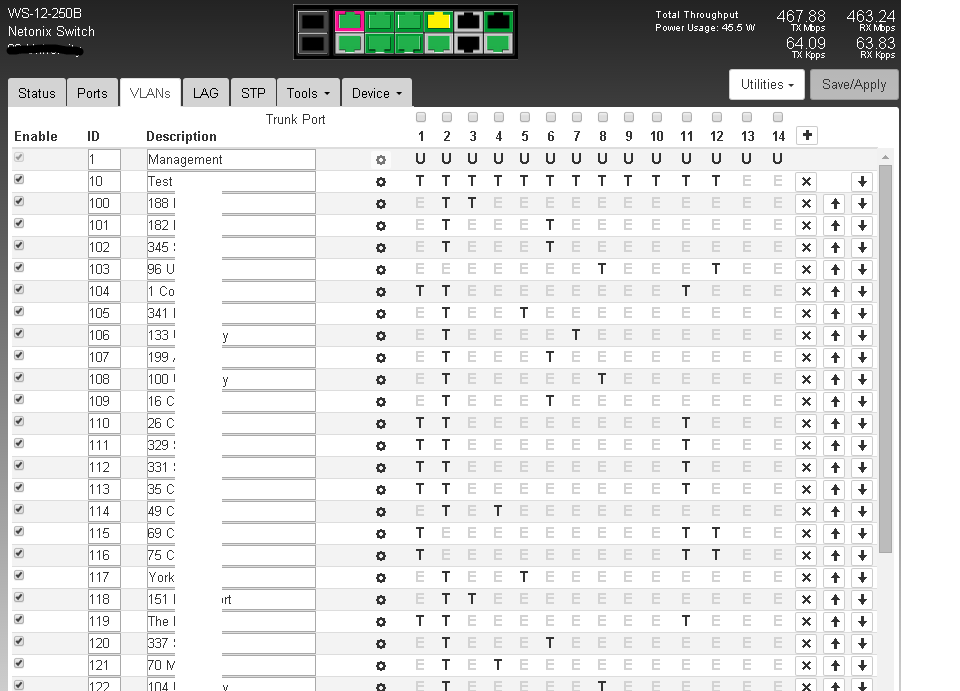

Here is the vlan tab no alterations.
Exempt vlan115 from port2 and tagged it on port12. we have the vlan tagged on multiple ports simply because we want the vlan to span multiple ports (this should work fine according to 802.1q standards, and works fine for us everywhere else).
What we are trying to do is migrate a NAT subnet from one router to another, the subnet is encapsulated in that vlan 115. so the default gateway which is on router1, would now because a default gateway on router2 by simply having the vlan reach router2 instead of router1. the ip address of the default gateway would be the same on both routers, so in order for it to work, router1 needs be disocnnected at same time as router2, or else you ahve IP conflict. So we experienced ip conflict.

menacers wrote:Exempt vlan115 from port2 and tagged it on port12. we have the vlan tagged on multiple ports simply because we want the vlan to span multiple ports (this should work fine according to 802.1q standards, and works fine for us everywhere else).
Yes you can do that.
menacers wrote:What we are trying to do is migrate a NAT subnet from one router to another, the subnet is encapsulated in that vlan 115. so the default gateway which is on router1, would now because a default gateway on router2 by simply having the vlan reach router2 instead of router1. the ip address of the default gateway would be the same on both routers, so in order for it to work, router1 needs be disocnnected at same time as router2, or else you ahve IP conflict. So we experienced ip conflict.
I need to think about this, I will try and take some time this evening and wrap my mind around what you're trying to do.
