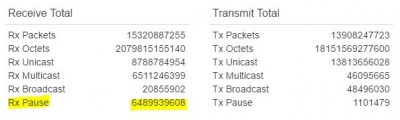

Has anyone had any success with enabling flow-control on the AC gear?
This is my port after 5 minutes. There's only 4 clients behind this AP and only 2mbps of traffic. I'm seeing this on other towers too with AC gear.
Running rc25 here, 1.3.9 on the other site. 8.0-b12 for the AC APs.
Rx Packets 49512
Rx Octets 6396711
Rx Unicast 45523
Rx Multicast 3857
Rx Broadcast 132
Rx Pause 19156

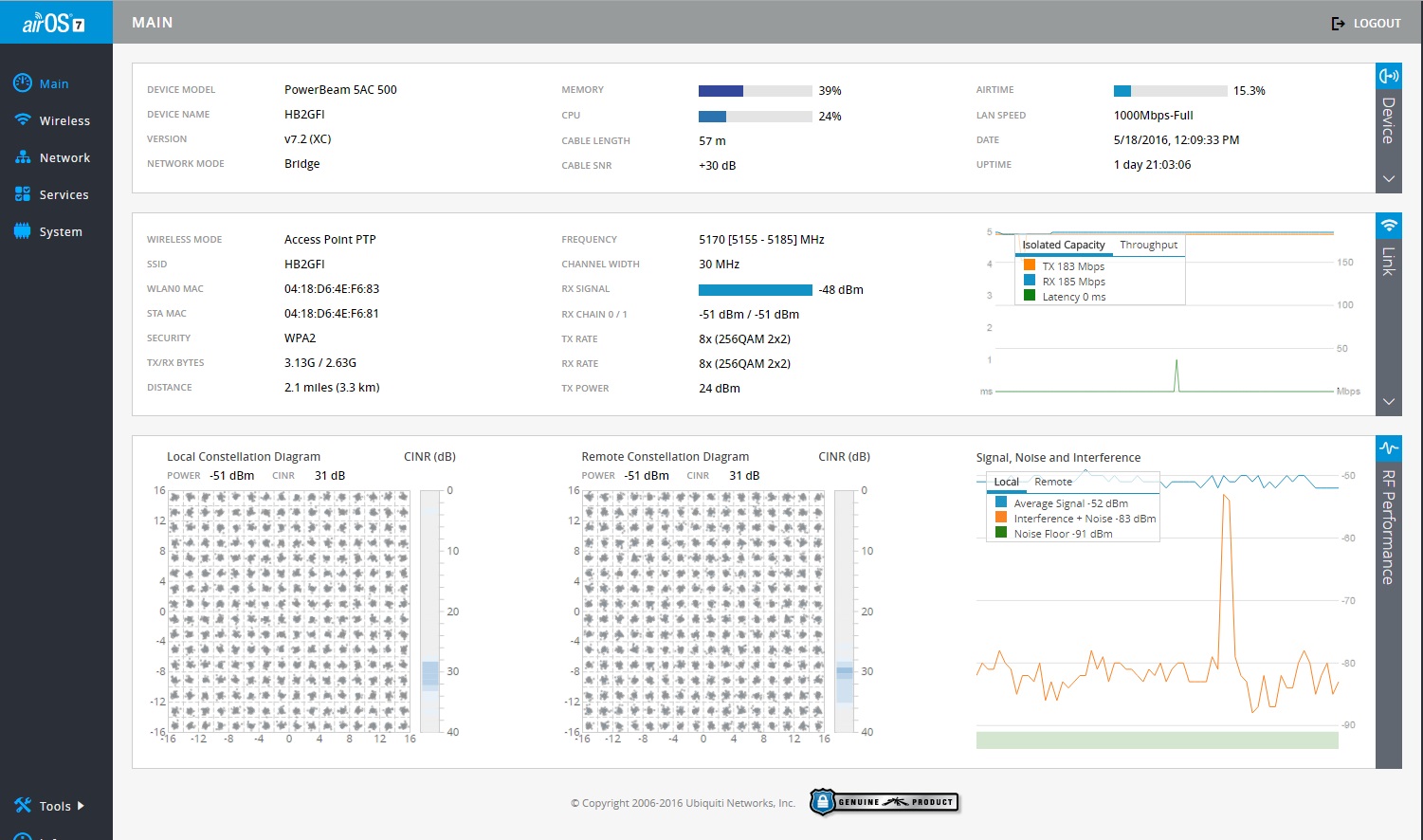

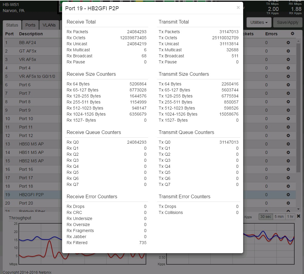

I only have one type of airMAX AC links in service and they are PowerBeam 500mm AC PTP links with RF Armor of course to high end customers. I do have flow control enabled and I am not having any issues but let me stress that these are relatively short links so the modulation is VERY STABLE as the signal is EXCELLENT. Note in the second picture no Rx or Tx pause frames are present but Flow Control is Active. But this is a PTP link and very stable modulation and GREAT SNR. SEE EXAMPLE PICTURE BELOW
One other person (Yahel) already reported that he "may" have seen this same weird behavior with airMAX AC equipment but was not sure.
I am not sure how the AC gear works compared to the airMAX M gear yet. The airMAX M gear did not transmit when there was no data going through the link and it only reported air rates which was not capacity but the AC gear seems to act similar to AF gear in that it reports capacity which could mean that they are transmitting all the time even with no payload. In that event they "could" suffer the same affliction as the AF radios when modulation changes or interference drops capacity?
This is only a guess?
CLICK IMAGE TO VIEW FULL SIZE

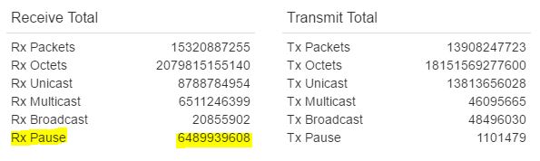

Here's a screen shot of one AC unit.
This is 42 seconds later...
That's 15,448 pause frames within 42 seconds. Kinda excessive. FYI everyone on this tower is at 256QAM.

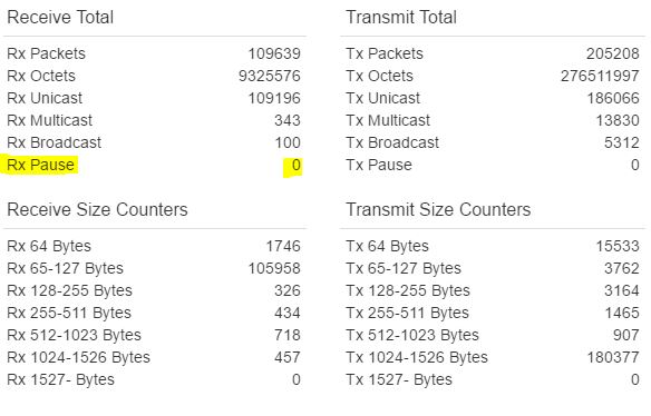

Wed May 18, 2016 6:18 pm
I can confirm this is happening on my tower with all AC gear. I turned Flow Control off and now I am seeing 0 Tx/Rx pause frames on all 5 of my Rocket AC PTMP units.
