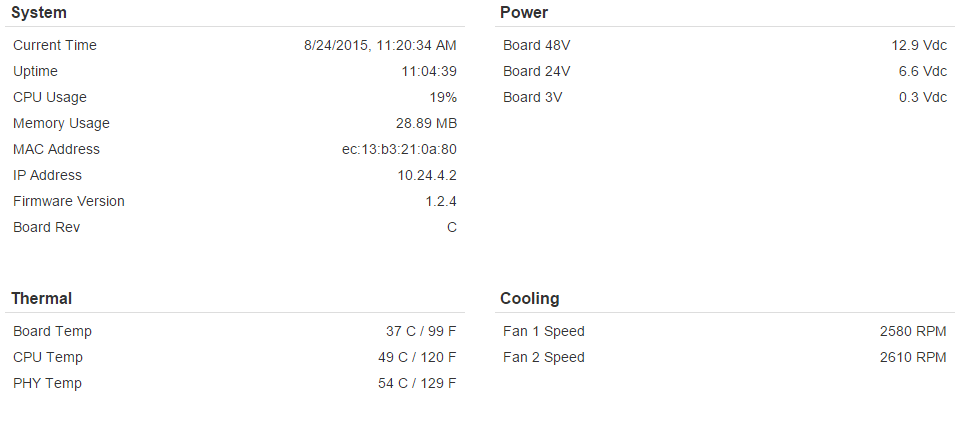

With regard to the switch with the grayed out 48v options, I have downgraded it to 1.2.4 and the 48V ports are working again.
Attached is a screenshot:
Also, regarding SFP modules, yes it has an SFP module, Cisco, unsure which model specifically.

Re: v1.3.0 & v1.3.1 FINAL bug reports and comments
Jknight wrote:With regard to the switch with the grayed out 48v options, I have downgraded it to 1.2.4 and the 48V ports are working again.
You can safely upgrade to v1.3.2 as we took that check out for all but the WS-12-DC unit(input voltage).
But the question still remains why are your voltages wrong? You will need to do some testing.
Is the voltages being reported wrong because the SFP modules are causing an issue with the I2C communications or is the board possibly damaged?
Please pull the SFP module(s) and check the input voltages (you may need to reboot after pulling the SFP).
If the voltages are incorrect without the SFP modules then either the board is damaged or something failed.
If the voltages still report incorrectly after removing the SFP modules I may ask you to visually inspect the board.
