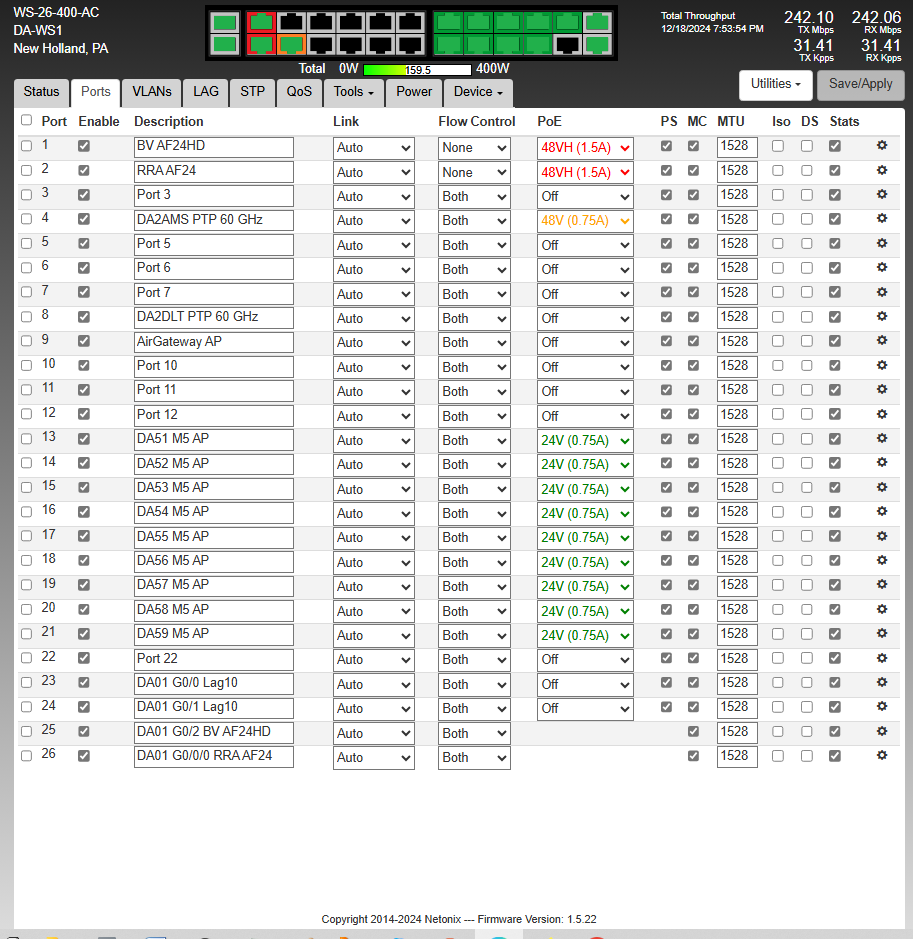

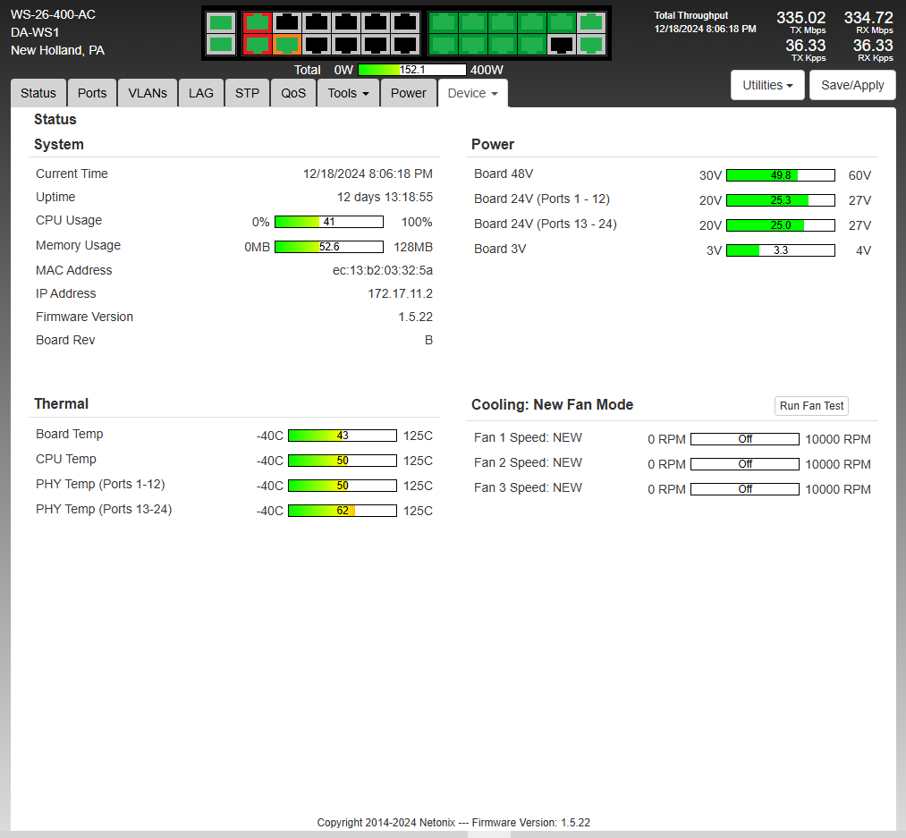

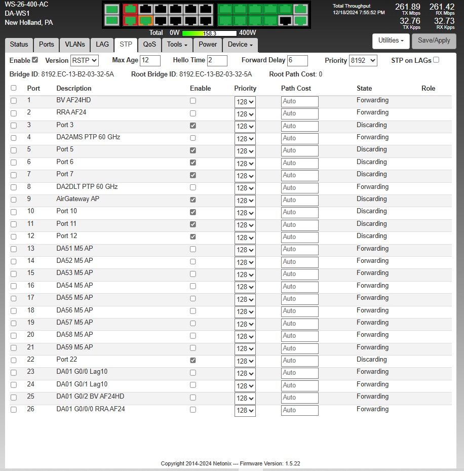

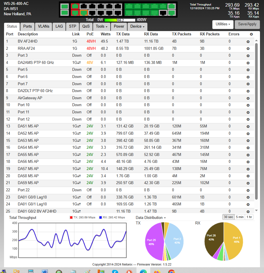

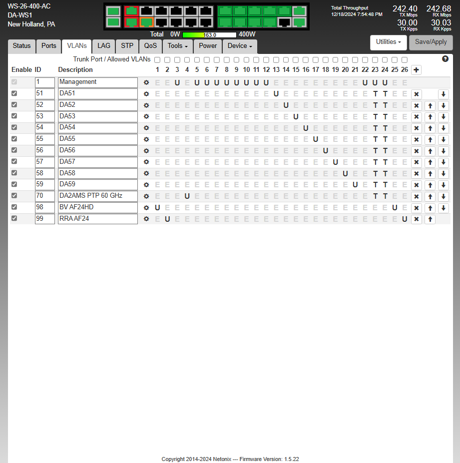

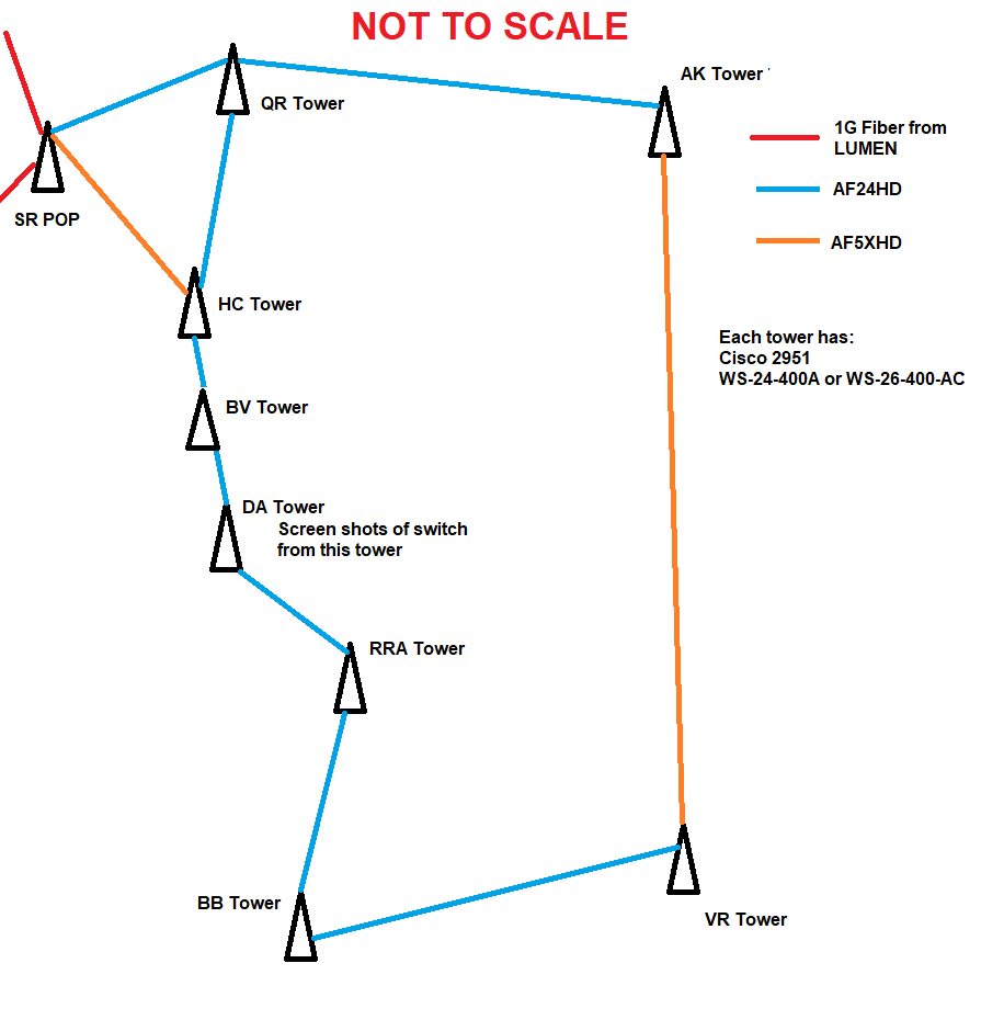

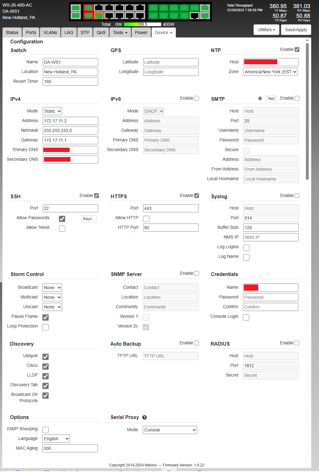

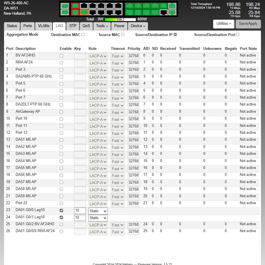

So here is my network (OSPF Ring) and 1 of my towers switch TABs that have any changes, see pic below:
Notice Port 1 is bonded (VLAN) to Port 25 - Bandwidth IN
Notice Port 2 is bonded (VLAN) to Port 26 - Bandwidth OUT
Ports 23 & 24 run a Static LAG to Cisco as 2951 will not support LACP. This just provides backup and load balance which is not really needed but hey.
Note: Whereas 2 towers (BV and VR - lightly loaded) still run original Rocket M5 most towers including DA screen shots are Rocket 5 AC Lite or AirPrism Gen 2, just never went back and renamed port descriptions.
I run OSPF ring in and out of each tower uses an SFP port bonded to a copper port. SFP Copper port goes to router (Cisco 2951) and copper port powers backhaul mostly AF24, AF24HD, or AF5XHD
I have no issues.
I assume you run VLANs?
Are you running PPPoE, I forget?

Not a media converter as SFP Port 25 is copper SFP to Cisco 2951 and Port 1 offers 48VH to power AF24HD (LOOK AT MY SCREEN SHOOTS ABOVE)
SFP Port 26 is also copper to Cisco 2951.
Port 1 and Port 25 are in a private untagged VLAN, again see screen shoots. (Backhaul from previous tower in loop)
Port 2 and Port 26 are in a private untagged VLAN, again see screen shoots. (Backhaul to next tower in loop)
