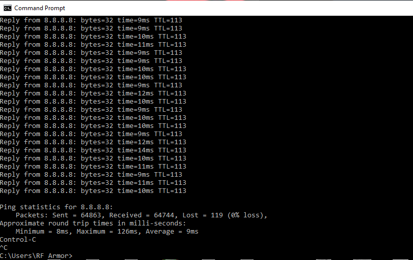

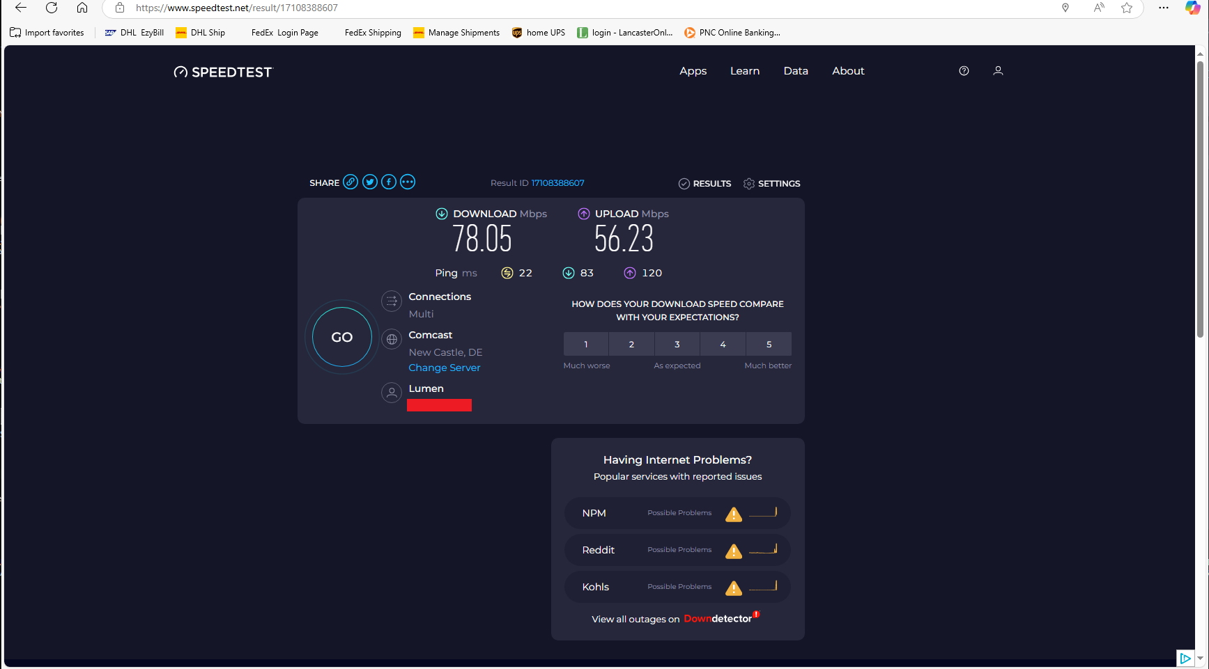

I always run constant pings to 8.8.8.8. Today I missed 1 out of 545 pings.
I have seen better speeds, but this is about average. Keep in mind I have a residential service here at RF Armor not a commercial account.
Also keep in mind there are several security cameras here running back to WISP office and about 8 computers here and a TV in the lunchroom that is always on streaming Newsmax.
