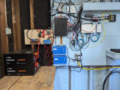

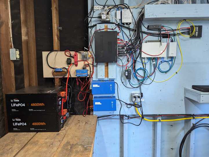

Chris - here's a sample site...
Not the cleanest site - but were I was today to replace a bad fan in a Netonix WS-26-250-DC
Seen mounted on the wall, next to a CCR1009-PC
On the left two 4800Wh batteries in parallel ($2200 just for these batteries).
Two AC Victron chargers
A Victron "Cerbo" controller and a Victron shant (BlueTooth) to measure current.
