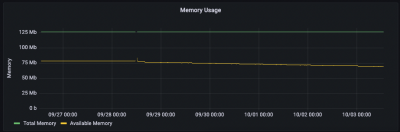

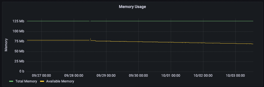

Quick update.
Have deployed our first switch on 1.5.14, and still getting the memory leak issue
The break in the graph is when the new switch was installed on the latest firmware
