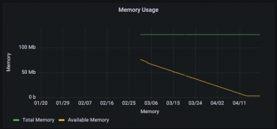

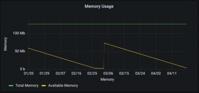

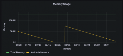

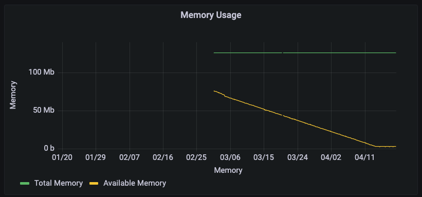

I suspect there is a memory leak somewhere.
While I am only running v1.5.11, given the notes on changes between this version and 1.5.12, I wouldn't expect there to be a difference between the two in terms of memory management.
I have three different models of switches running v1.5.11 and all three of them are exhibiting constant decrease in available memory, and when available memory gets to 0 and something needs memory allocated (like web UI login), the switch reboots itself. Not great when this happens at peak times during the day.
We see the exact same issue on switches running any firmwares older than v1.5.5 and has been fine up to v1.5.8. But seems to have come back since the string of firmware versions trying to patch TLS support. Graphs below to show available memory linear regression.
WS-8-150-DC (last 90 days) - board rev F:
WS-12-250-DC (last 90 days) - board rev F:
WS-26-400-IDC (last 90 days) - board rev B:
The WS-8 and WS-26 are both new out of box.

I am running v1.5.11 and v1.5.12 on many switches not seeing this at all???
If you have services loaded such as Discovery Tab or Discovery protocols and so on try disabling them 1 at a time and narrow it down.

Re: v1.5.12 Bug Reports and Comments
Thanks for that.
We have discovery enabled on all of our switches on our network (177 in total), so would be odd that we are only experiencing it now on the new firmware (and the old firmwares mentioned).
But I will test disabling these one-by-one over the following week and get back to you with results.
