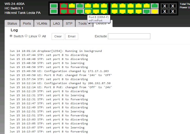

I'm forwarding a request. Would it be possible to add port descriptions (when available) to the syslog instead of just the port numbers? It would make them more readable without having to memorize all the ports on all the switches.
Re: v1.2.2 FINAL bug reports and comments
We could do that but the log entry would sometimes be long and cause word wrap and it would eat up more memory. I would like to conserve memory for some cool feature we are planning like longer historical periods for graphing.
If you see an entry in the log like in the picture below, say port 8.
Now all you have to do is move your mouse cursor to hover over port 8 and a balloon will pop up and tell you the Description/Name.
Now mind you print screen does not show the course but I have my mouse cursor hovering over port 8.

I guess what he was referring to was the remote syslog.
