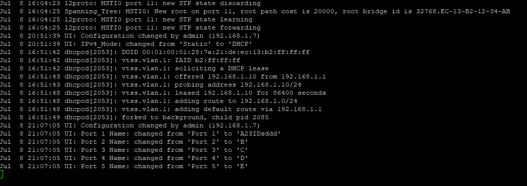

Following my previous post I attempted to test my theory that firmware slot #1 was functioning differently to slot #0. The following takes place immediately after point 7.1 of my previous post.
1. Enabled DHCP
1.1. Switch did not get an IP, rebooted
1.2 Upon reboot switch received a DHCP lease
2. Signed into switch (via direct ethernet connection)
3. renamed switch ports to match intended production config
3.1 config change successful
4. Seemingly at random switch lost IP address
4.1. 'ip address' command reports switch IP is 169.254.73.148
Conclusion:
Switch continues to exhibit seemingly random glitches and issues.

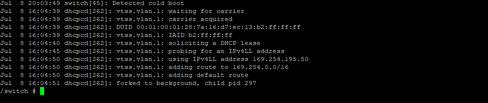

If I disconnect the network cable to my switch and change from static to DHCP from the console port directly then I was finally able to replicate the issue's you've been mentioning.

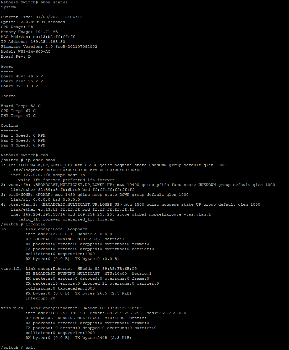

The first thing that happened when dhcp inevitably failed to obtain a lease is that the results from
Would sometimes show the IP address as "Unknown"
Other times it would catch it when the system reverts to the 169 default IP.
And using the system command:
or
Showed the ip address to be 169.254.195.50/24 for the vtss.vlan.1 interface.
Which is a default private IP built into the network driver.
Here are the logs of the event:
Here are the results from the above commands (by the time I captured it, it was on an instance where it caught the default ip):
- Code: Select all
show status
- Code: Select all
ip addr show
or
- Code: Select all
ifconfig
