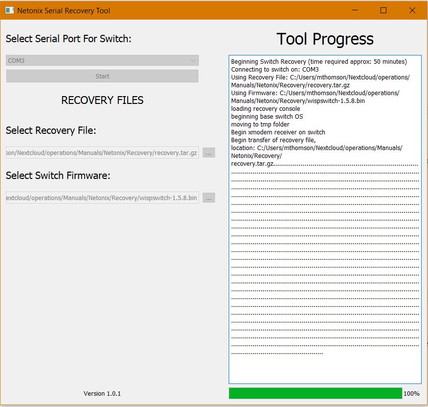

How do I know when the recovery tool has completed it's work?
I have a WS-12-250-DC switch that we placed into service at one of our remote sites and it failed approximately 8 hours later. The switch was replaced with a spare and I am in the process of trying to resurrect the failed switch.
Trying to connect via the serial port does not elicit any response from the CLI. I am using puTTY and have double checked my COM settings (115,200 8 N 1), powered the switch off/on several times. No text in puTTY and no response to any carriage returns. I was expecting to see some messages as the switch booted. Also, when the switch powers up, the fan runs at full speed and does not either slow down or turn off.
I am now on my second try with the recovery tool but I am unsure if the switch is responding to the recovery tool.

The recovery tool will actually tell you when it's finished in the Tool Progress output box.
The recovery tool is just an automated version of performing this recovery procedure manually, in case of a failed update or if the flash got corrupted some other way.
However, if the terminal does not respond at all when viewing output on PuTTY when the switch is turned on. Then the recovery tool can't help and the switch most likely needs to be RMA'd.

Re: RECOVERY TOOL VIA SERIAL FOR SWITCHES
Thanks, Stephen.
I have attached a screen capture of what I am seeing from the recovery tool.
I was suspecting that not having any response from the CLI was a bad sign.
