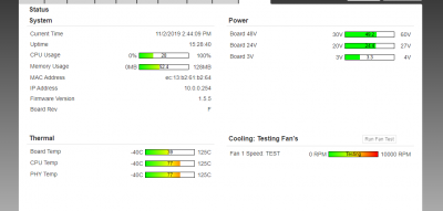

After upgrade to 1.5.5 fan stopped operate. CPU and PHY is about 75 C. Run Fan Test is ok - 10k rpm.
Re: v1.5.5 Bug Reports and Comments
ogreland wrote:After upgrade to 1.5.5 fan stopped operate. CPU and PHY is about 75 C. Run Fan Test is ok - 10k rpm.
Maybe because you upgraded from an much older firmware and we had changed the temps fan operate at.
Fan does not start until board temp is 45C
Post up a screen grab of your DEVICE/STATUS TAB

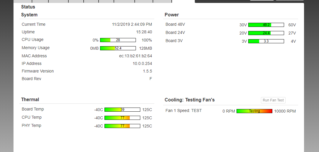

sirhc wrote:ogreland wrote:After upgrade to 1.5.5 fan stopped operate. CPU and PHY is about 75 C. Run Fan Test is ok - 10k rpm.

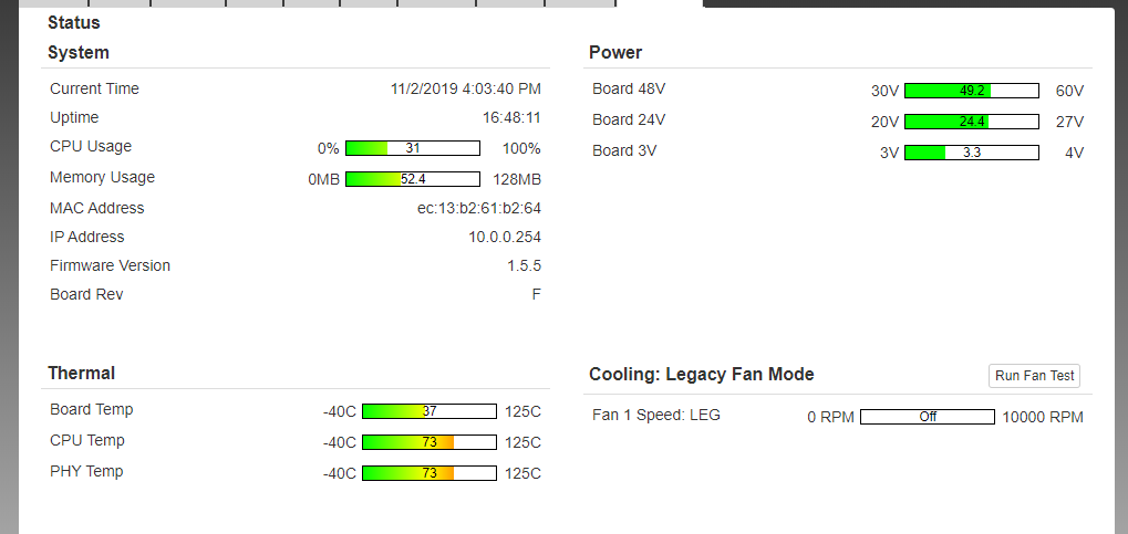

Yes, i have upgraded from old version.
Below is a stats.
Looks FINE.
When your board temp reaches 45C the fan will kick on.
The CPU and PHY are rated to run at 125C
Discussed many many times already, there is a search feature on the forums to find the info you need.
https://forum.netonix.com/viewtopic.php?f=6&t=4918&p=27922&hilit=45C#p27922
https://forum.netonix.com/viewtopic.php?f=6&t=4918&p=27929&hilit=45C#p27929
https://forum.netonix.com/viewtopic.php?f=17&t=5528&p=29708&hilit=45C#p29708
https://forum.netonix.com/viewtopic.php?f=6&t=4983&p=28200&hilit=45C#p28200
sirhc wrote:Looks FINE.
Discussed many many times already...
A bit of a digression but if the colour would stay green for longer and not do a Chicken Little impression, then folks might not panic as often.
