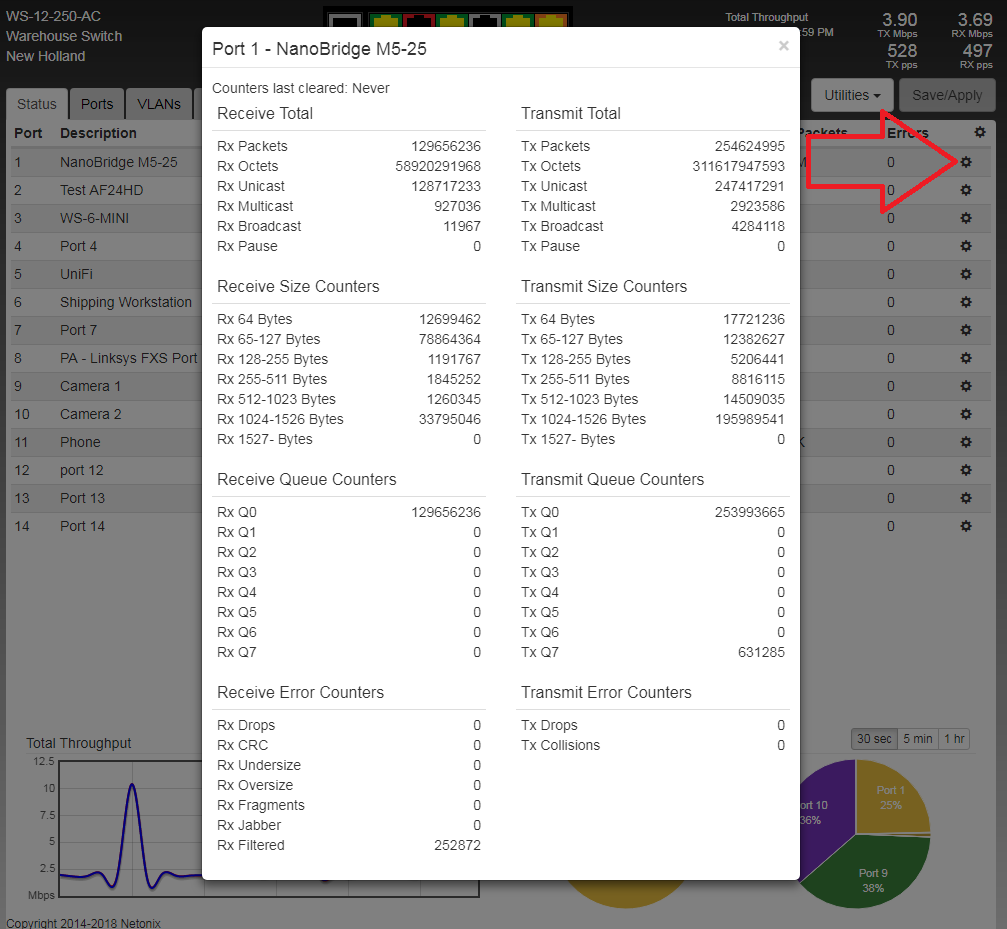

Did you look at the port statistics in the switch by clicking on the little gear to right of the port row and select Port Details from the pop up?
Maybe put up a few screen grabs of the ports in question.

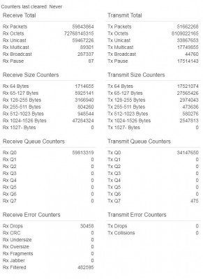

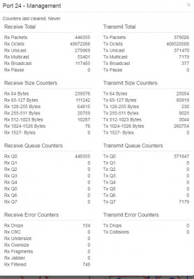

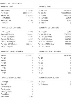

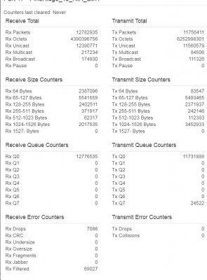

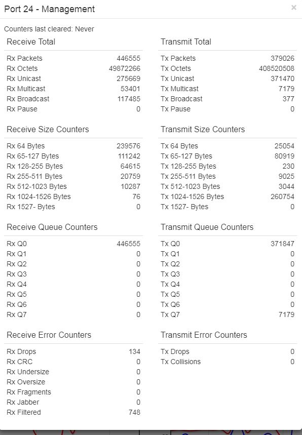

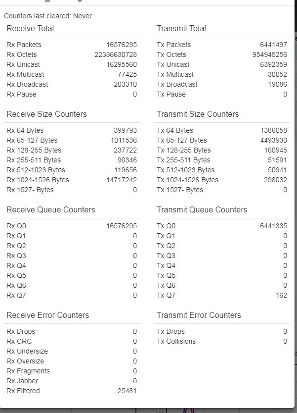

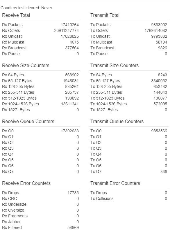

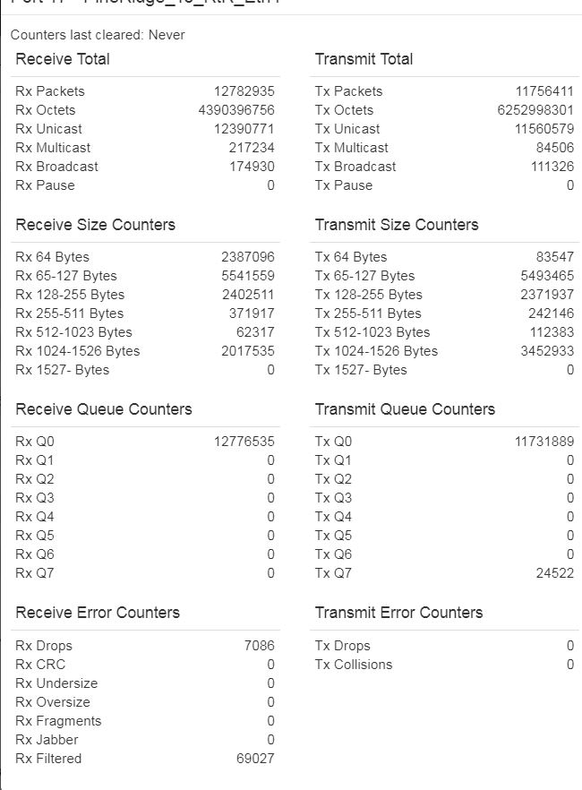

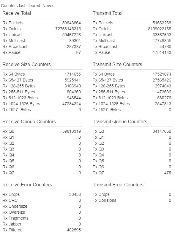

These are from the Fiber/Ethernet network that was upgraded from 1.4.7 to 1.5.0 on Monday 2-3% packet loss consistently. Previously 0% packet loss
Re: monitor: restarting vtss_appl
There are no CRC or any errors on the ports to indicate a problem on the links to indicate a reason for packet loss.
