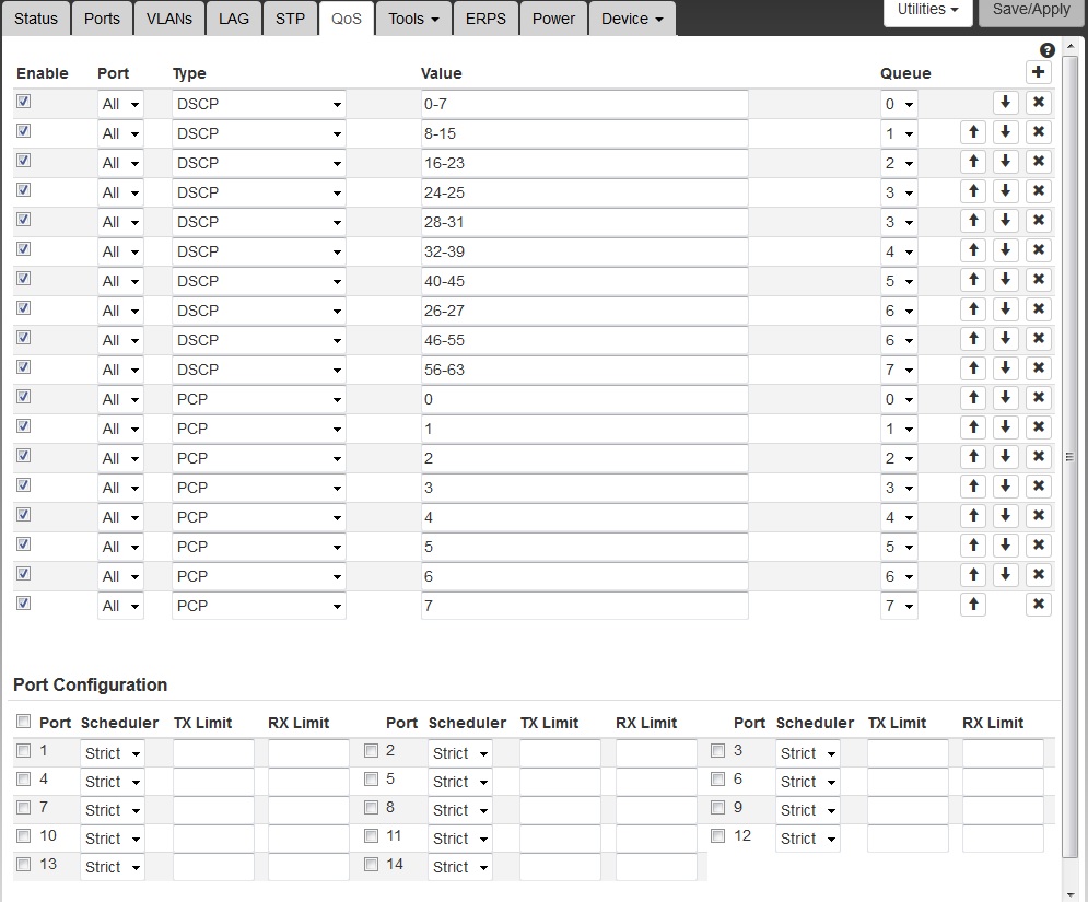

Re: v1.4.9 Bug reports and Comments
Wed Jan 17, 2018 7:46 pm
There is some issue with QOS in 1.4.9. Since upgrade to 1.4.9 twenty four hours ago (5 switches in our network) many customers started to complain about not possibility to watch online videos...that sound is not synchronized with video. When I disabled all QOS rules in all switches, the problem was 100% solved. Other 100% solution is downgrade to 1.4.8 and keep all QOS rules active as before. So we stay on 1.4.8 ...
Example of our QOS tab is here:
