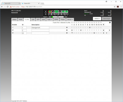

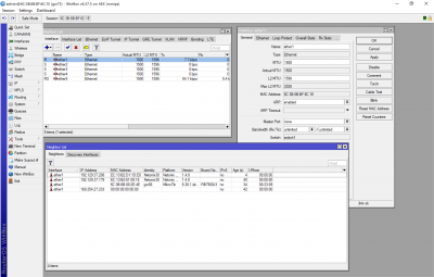

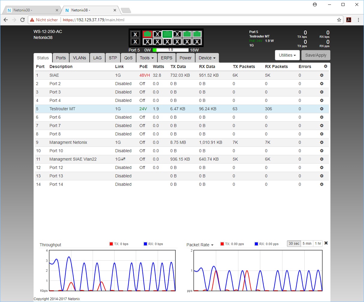

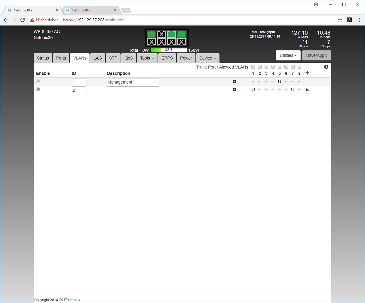

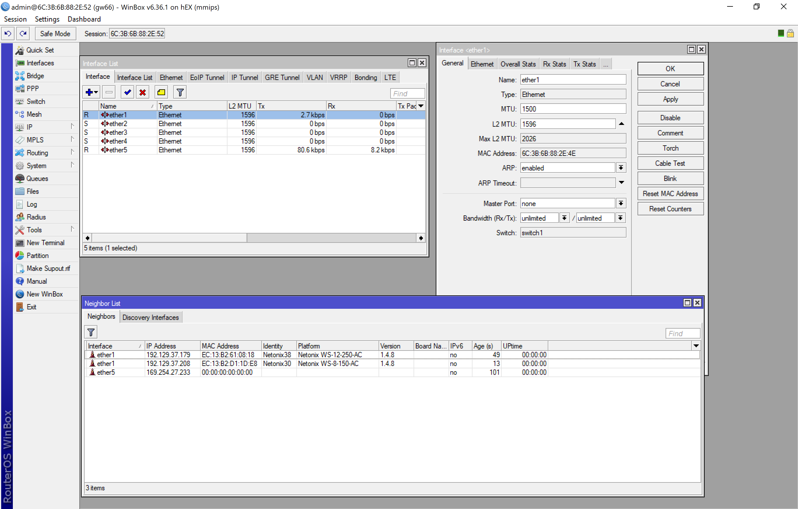

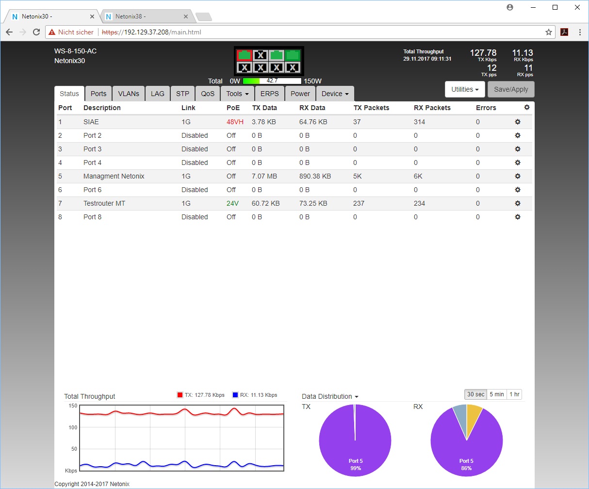

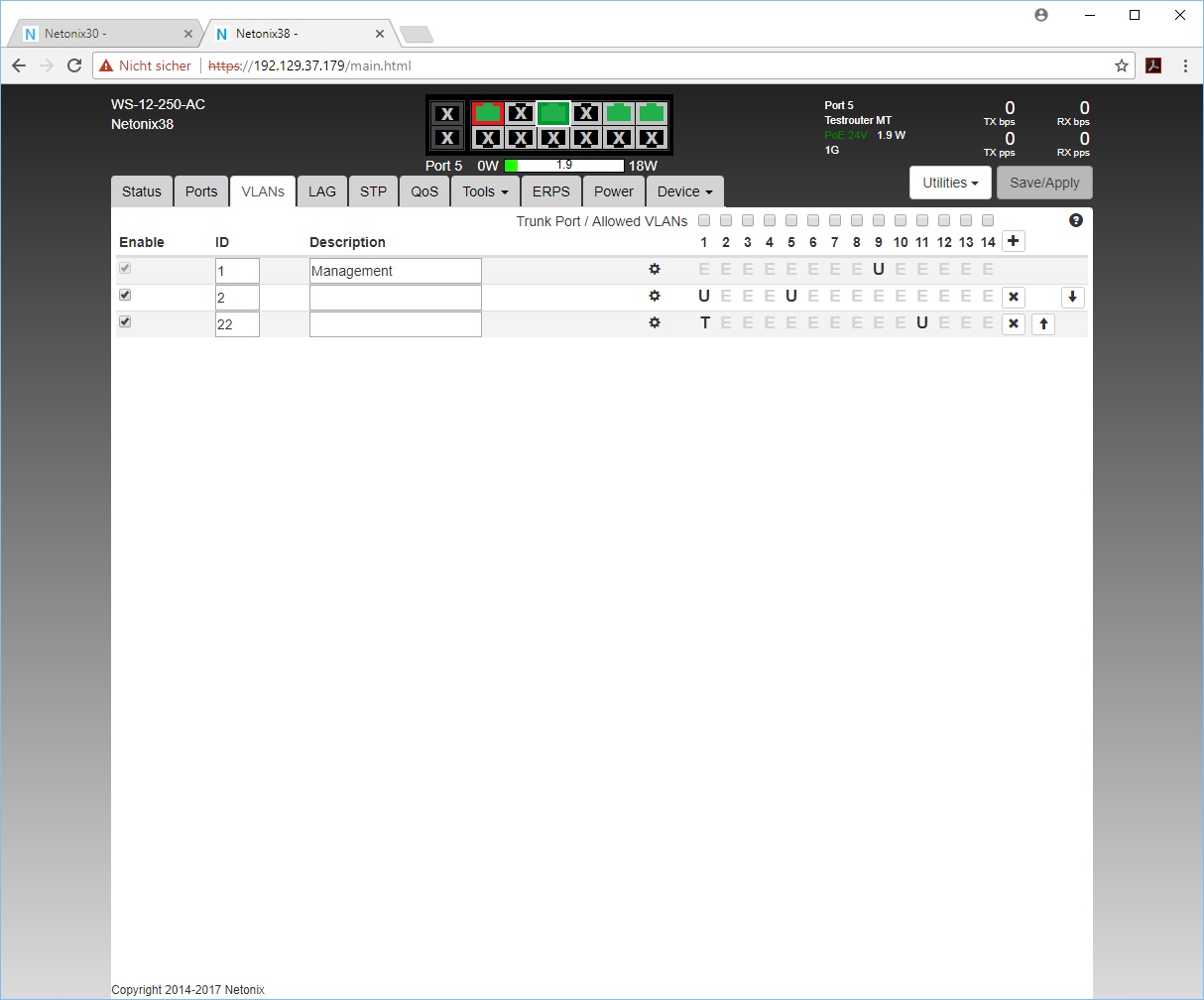

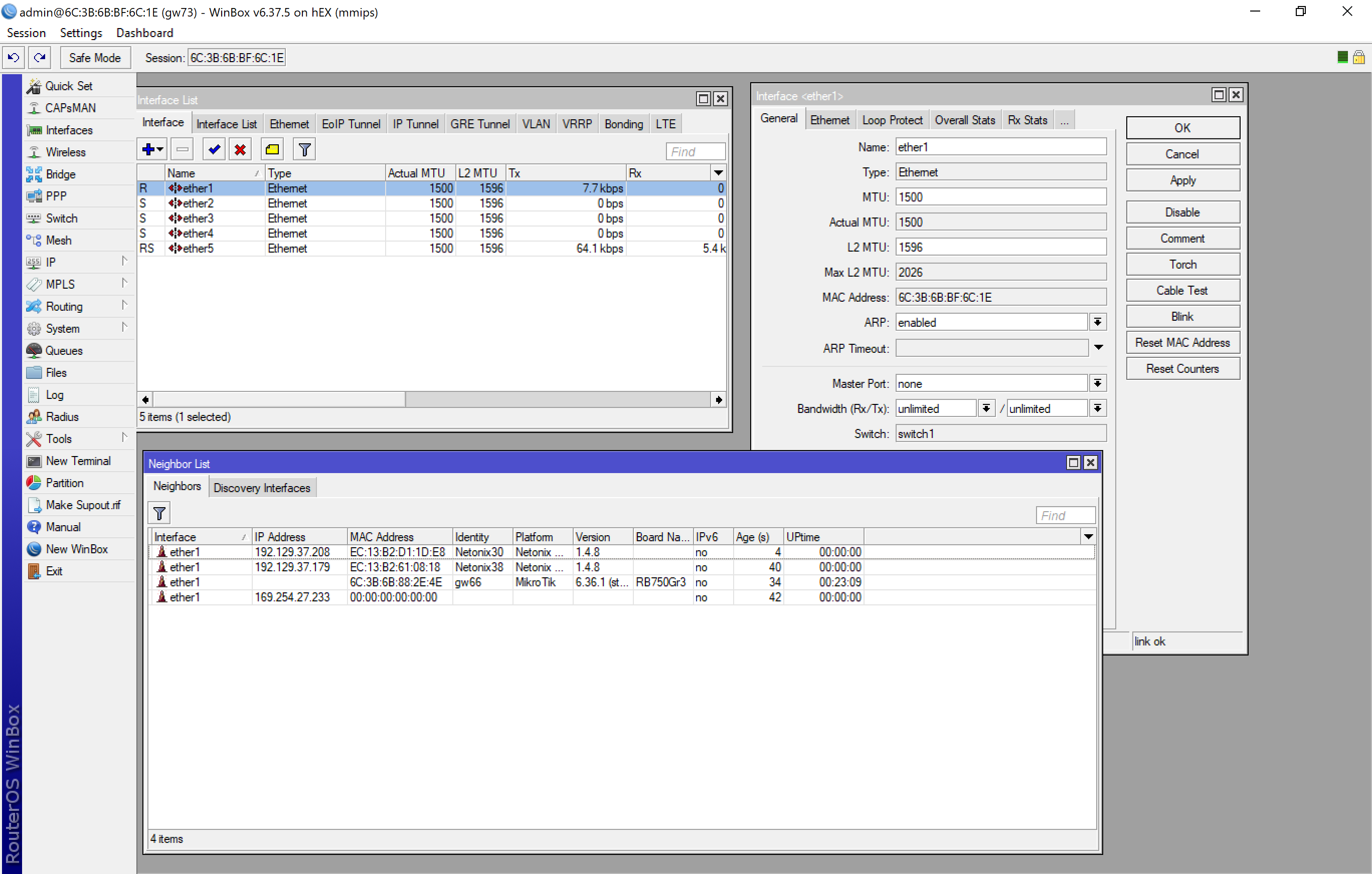

ste wrote:
sirhc wrote:What is the MTU set on the radios in the bridge and the MT ?
Default settings. I look tomorrow. But as the Mikrotik Discovery packets aren't that big I guess this could not be the problem.
SIAE link is set to max packet size = 2048.
I removed all ports not used from vlan. vlan22 is the managment vlan of the SIAE link. There is one laptop attached to mangage both SIAEs from one side. This works. The link is configured to pass untagged traffic through. Vlan2 is used for this. Managment Vlan of Netonix switches is 1. This is used only to manage both netonix switches.
I cant see a problem why Netonix30 does not forward the Discovery packets of gw73 to the link. Replacing Netonix30 with a POE-Adapter make it work without any config change.
IntL-Daniel

ste
Posts: 84
Joined: Fri May 22, 2015 5:33 am
Location: Regensburg Germany
Has thanked: 2 times
Been thanked: 13 times
Re: v1.4.8 Bug reports and Comments
Fri Dec 01, 2017 6:31 am
ste wrote:
Replaced with an EdgeSwitch. Works now. Some kind of incompatibility between WS-8-150-AC and SIAE (The WS-12-250-AC on the other side does not show this problem). As I cant get a solution I have to replace Netonix on sites where I want to use SIAE.
Posts: 7634
Been thanked: 1361 times
Fri Dec 01, 2017 9:57 am

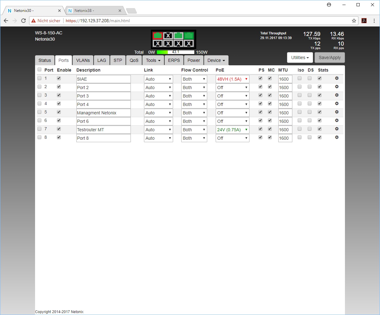

There is "nothing" different between any of our switch models, they all use the exact same switch core, and exact same firmware.
If a WS-12-250-AC works and a WS-8-150-AC does not then there has to be something you missed?

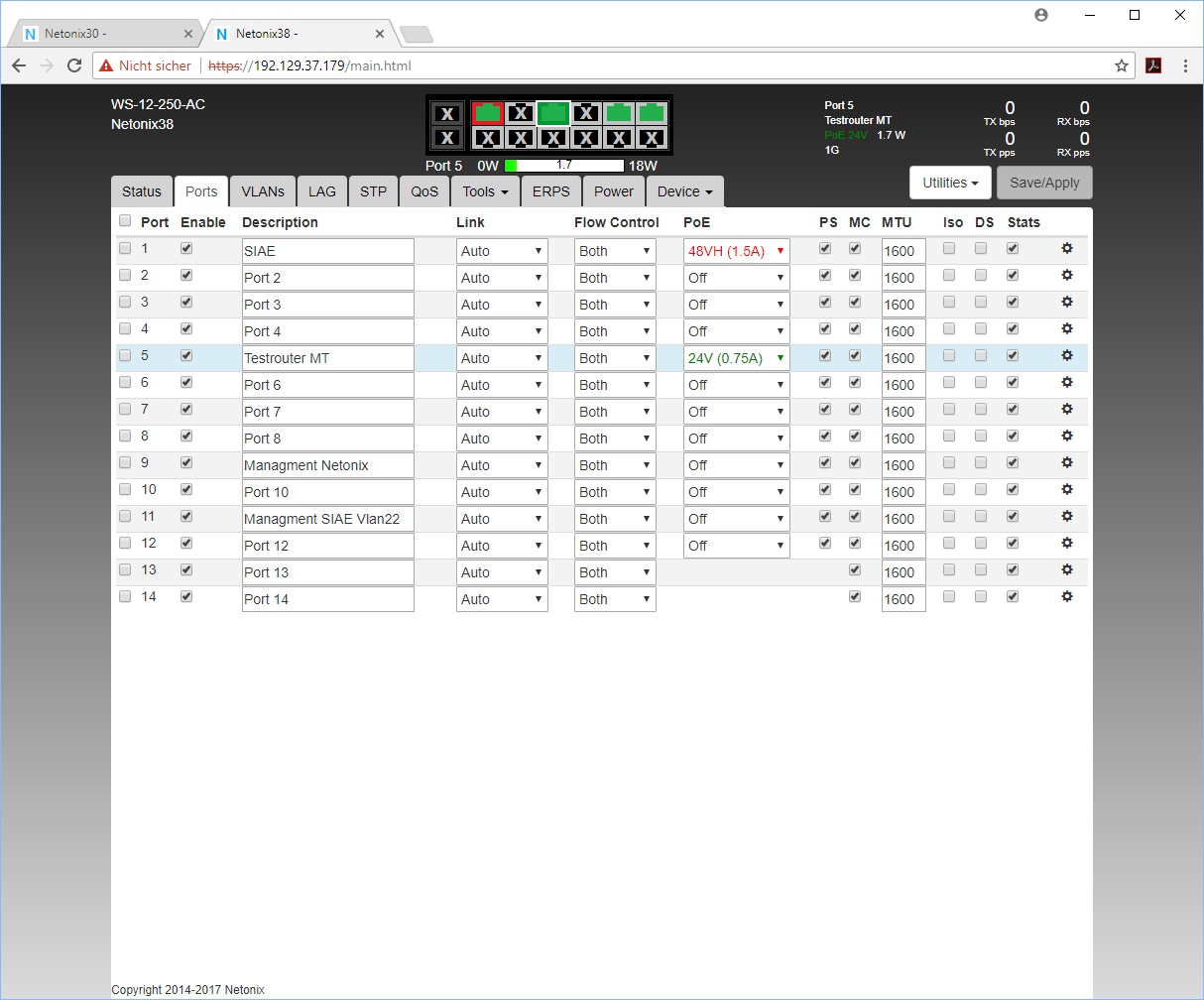

ste wrote: SIAE link is set to max packet size = 2048.
Yet you have the Netonix MTU set to 1600 on your Ports TAB screen grab above ??????
Increase the MTU on the Netonix to 2048 or higher, I would set the Netonix switch higher, say 2048 + 6 = 2054 as some manufacturers add padding to their MTU setting for user error we do not.

ste
Posts: 84
Sat Dec 02, 2017 2:05 am
How should this help small cdp packets pass the switch? Siae distributor wanted me to check the routing table... I dont like this supporters telling me anything that comes to their mind just to keep me working and be quiet for a while. This is the reason we seized using cambium. When they have a problem support keeps you busy.
