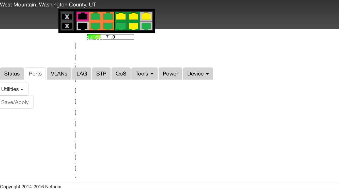

I have 1.4.5rc4 on a WS-12-250-AC. Display is all jacked up when viewing it mobile on my iPhone on safari. 1.4.2 from the same device/browser works fine.
IntL-Daniel
Posts: 175
Location: Czech Republic
Has thanked: 7 times
Been thanked: 10 times
Re: v1.4.5rcX Bug Reports and Comments
Sat Oct 15, 2016 6:13 pm
I have the same experience...useles on any mobile browser on Android.

Same issue with the iPhone as listed above.
