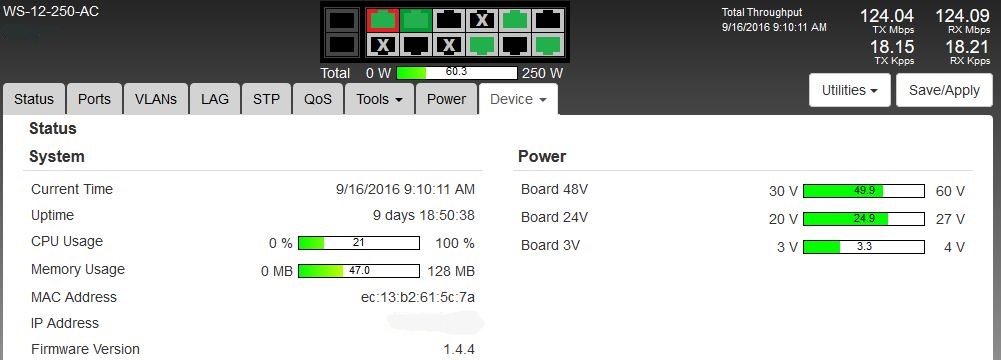

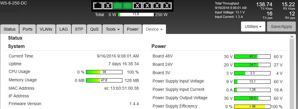

Re: v1.4.4 Bug Reports and Comments
Fri Sep 16, 2016 11:34 am
I have a couple WS-8-250-DC which seem to always have higher CPU usage compared to their AC powered counterparts even though traffic is significantly less. On DC units where every watt matters, high CPU usage is not desirable. This didn't necessarily show up on v1.4.4. I do not have STP enabled. This DC switch is just used as a bridge powering two Ubiquiti antennas.
Fri Sep 16, 2016 11:52 am
mtngoat wrote:I have a couple WS-8-250-DC which seem to always have higher CPU usage compared to their AC powered counterparts even though traffic is significantly less. On DC units where every watt matters, high CPU usage is not desirable. This didn't necessarily show up on v1.4.4. I do not have STP enabled. This DC switch is just used as a bridge powering two Ubiquiti antennas.
I have explained many times that the CPU your looking at has nothing to do with switch traffic, here are a couple of posts discussing this.
http://forum.netonix.com/viewtopic.php?f=6&t=1993&p=14719&hilit=+cpu+switch+core#p14719
http://forum.netonix.com/viewtopic.php?f=17&t=1633&p=12136&hilit=+cpu+switch+core#p12136
That is because the DC switch CPU is doing more than the AC CPU counterpart.
If it is the WS-12-250-DC it is talking to the power supply CPU and keeping track of all the extra stats you guys wanted like 24 hour input voltage and current graphs.
If it is the WS-8-150-DC that is because there is no secondary power supply CPU and the CPU has to monitor and control the input voltages plus again keep track of all the extra stats you guys wanted like 24 hour input voltage and current graphs.
Plus the DC models are watching input voltages and current and taking appropriate steps in the event input voltage drops like turning off POE ports based on priorities you define to keep the site up.
Well, not much we can do about that, sorry. People keep asking for more and more creature features like graphs and stuff and all this stuff takes CPU clock cycles. However the 10%-20% increase in CPU utilization is less than .25 watts
mtngoat
Posts: 25
Joined: Mon Feb 16, 2015 3:37 pm
Has thanked: 2 times
Been thanked: 9 times
Fri Sep 16, 2016 12:26 pm
Many thanks for the quick reply. I did a search, but did not find the posts you mentioned.
Good to know the watt usage is minimal. I guess I spent too many years as a computer tech tracking down and stopping things eating the CPU.Image
