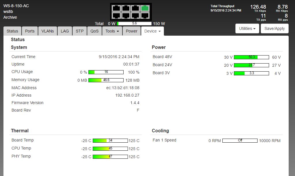

OK so this is interesting...
One WS-8-150-AC I took out of service for fluctuations and was going to RMA is on the bench and very stable with nothing plugged in.
Perhaps I pulled the trigger too soon on the nuclear option of fibre... oh well no big deal... needed more ports anyway.

Plug 4 or 5 Eth devices into the switch, does not need to be poe devices just Eth links and the fluctuation may return.

sirhc wrote:Plug 4 or 5 Eth devices into the switch, does not need to be poe devices just Eth links and the fluctuation may return.
Yep, started to fluctuate at the 5th device.
Not as bad as it did before.
Will wait to hear what y'all come up with.
