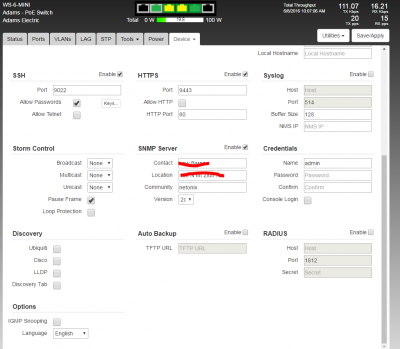

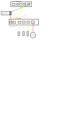

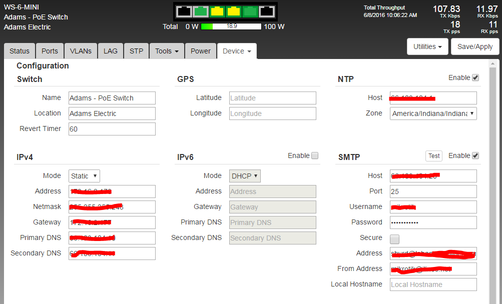

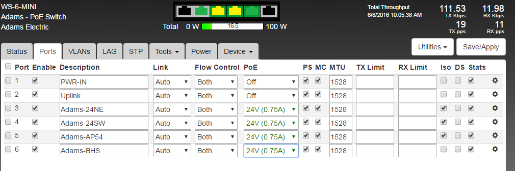

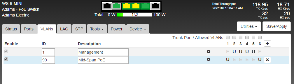

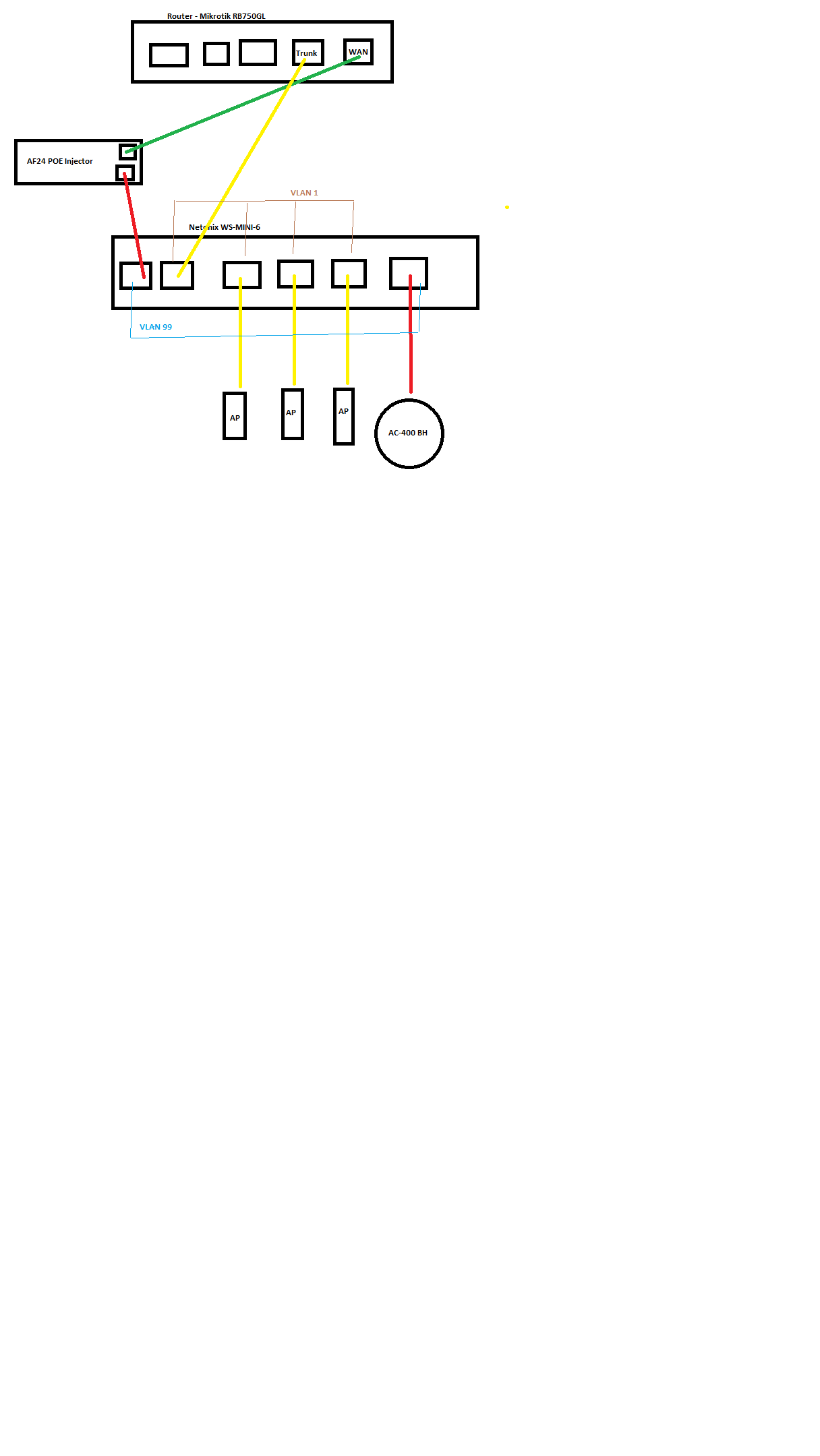

Forgive my drawings but here is my config along with a crude image of the network diagram at the site. Any Tabs not listed were left at factory defaults.

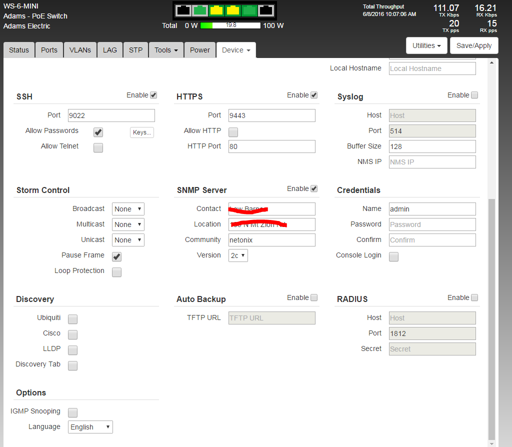

Re: WS-6-MINI Keeps crashing/rebooting?
Post up your Status and Device/Status Tabs
Also watch your voltage and watts readings for awhile during peaks.

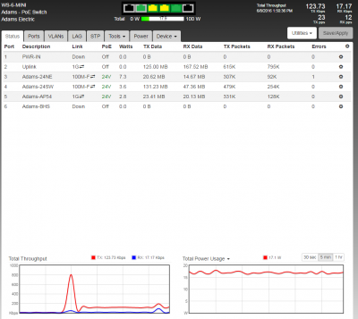

Mikrotik is NOT being powered by the switch. Currently there are no customers on the tower so power usage stays fairly low.

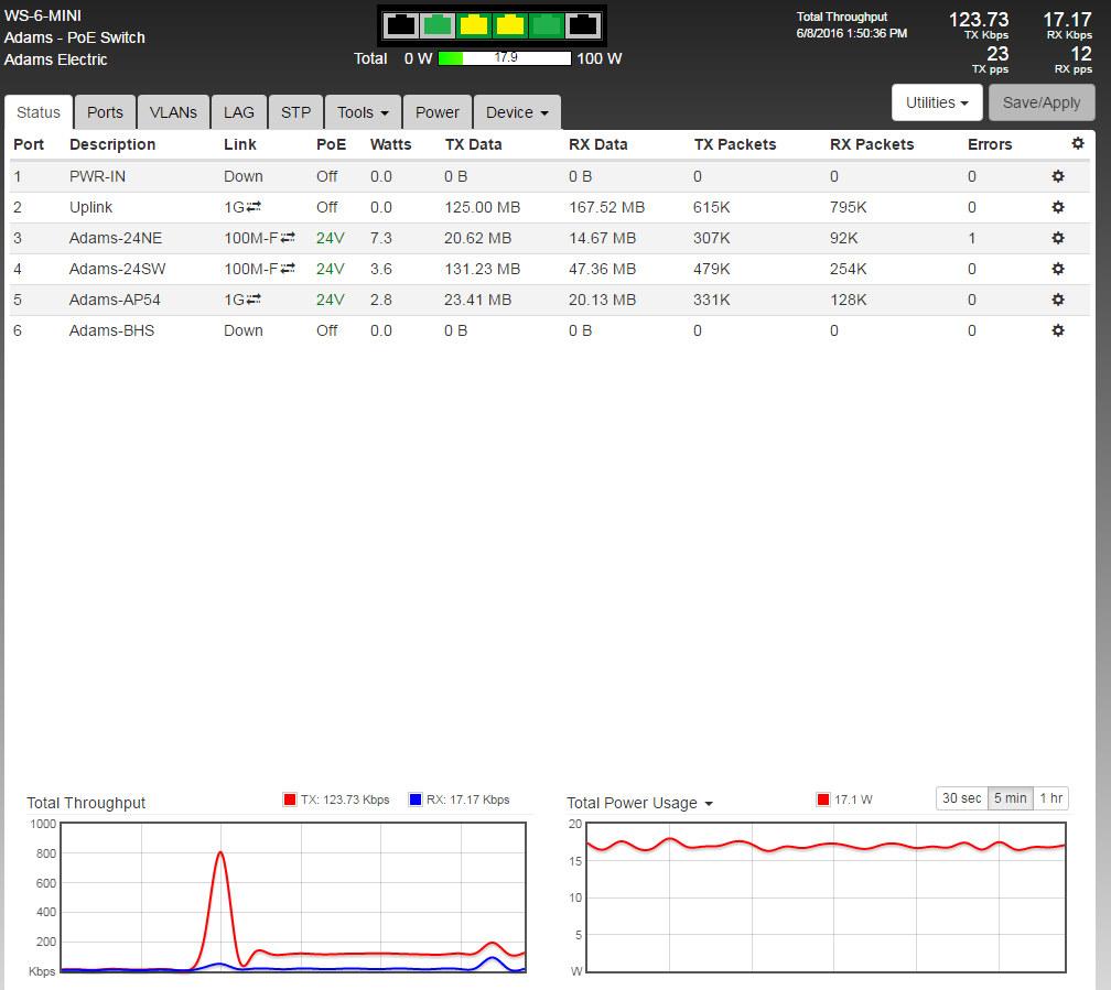

Here is my Status Tab.
I do not have the AC-400 (port 6) being powered or even run through the Netonix switch at this time so take its power draw into account.
What I have not tried is powering the AC-400 with the passive UBNT power supply, but still having the AC-400 run through the switch. Would eliminate power problems from being the issue?

DO you have RSTP and or Loop Protection enabled? You may be creating a loop somehow (remember did not look at your config to close yet)
