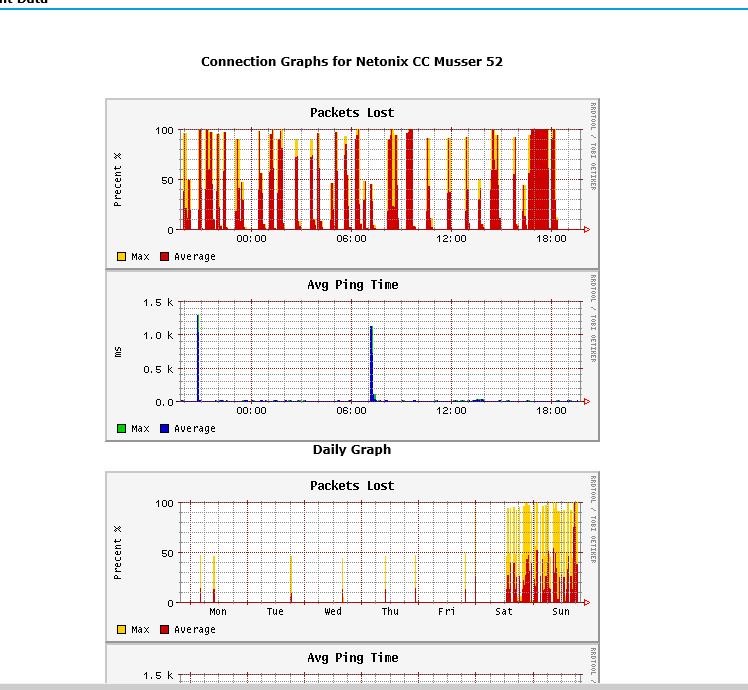

Re: v1.4.0 Bug Reports and Comments
I set back to 14.0RC19 which I think I was on before and issue cleared up
But I have no clue, that is the only thing done at that location in months,
