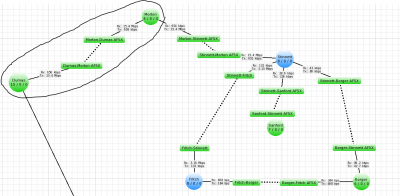

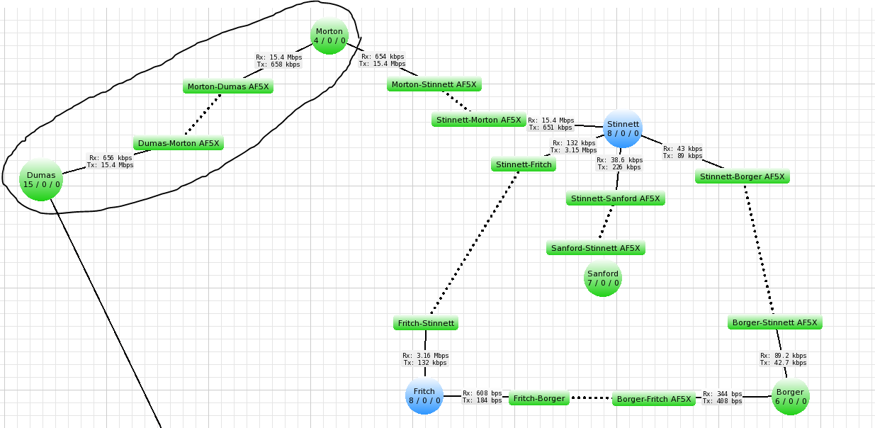

The problem happens with the switches circled.
Dumas has Fiber>Mikrotik router>WS12>WS6>AF5xLinktoMorton>WS12>AF5xLinktoStinnet (and so on down the line)
It used to be Fiber>Mikrotik router>WS12>AF5xLinktoMorton>WS12>AF5xLinktoStinnet (no WS6 in the middle) but the cable run was a little long and we needed to run another sector down on the other end of this elevator. The AF5X and it's cable at Dumas changed along with the WS12. Since the problem was there before the WS6 was installed than I suspect it's not the problem AND when the problem happens (16K pps and 8Mb traffic) we see it as incoming traffic to the WS6 on the port with the AF5X hooked to it.
If I was watching for the problem and noticed the traffic jump, and I was logged in to the WS6 running the AF5x and disabled the port, the WS6 and the WS12 at Dumas would not lock up.
This makes me pretty sure the problem is at Morton, as it and Dumas are the only ones that ever have to get rebooted by the netbooter's.
What I'm not sure of is if the problem is with Stinnett, blowing traffic towards Morton and Dumas. I just know it doesn't lock up.
We will focus on Morton next.

From my previous post where I showed that there didn't used to be a WS6 in line with the AF5X and this was still a problem.
I thought the long cable and the errors the port was taking were causing the problem. The port(s) no longer take errors now with the WS6 inline but the problem still occurs.
It's worth mentioning I attempted to capture this traffic via a port mirror and wireshark when I was on site and I didn't see anything the looked out of the ordinary. (I have the capture file if you want to see it) Just arp traffic and other traffic the PC running wireshark was generating.
What's odd is that when I had the mirror up, I didn't see equal traffic coming out of the mirror port.
For instance, I had port 3 set to mirror to port 7 where my laptop was plugged in. While port 3 saw 8Mb and 16K pps, port 7 did not. It's like the switch was just eating the traffic..
There is nothing different about these site configurations than any other site we have. I've gone through and verified the switches and router configs multiple times.
And yes, we are a little frustrated with the issue. It's obviously customer affecting as there is 8-10 minutes of down time every time they lock up, reboot and all the links reestablish.
The bigger part of my frustration was coming from your attitude towards the issue, honestly. You can't just throw up a wall and say we have 50,000 switches out there, this isn't a problem! When clearly there is. I appreciate you taking the time to work with us on this finally. I'm not trying to sound ungrateful. But we need a solution.
