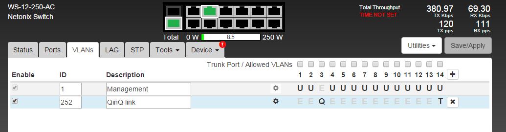

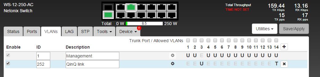

cegner wrote:I tested it with a second Netonix switch, same problem. Please take a few minutes to reproduce it, there seems to be a bug in the firmware. When adding a QinQ vlan to a mixed port, that is also used for managment, I leads to loss of connection/revert.
- Port 14: Management vlan (1) untagged, other vlans tagged.
- Port 3: Vlan 123 "Q", port 14 "T"
Then save and access is lost until the switch reverts.
I tried duplicating this problem but it seems to work fine.
Before
After
Is this the same test you are doing?
