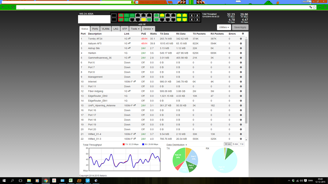

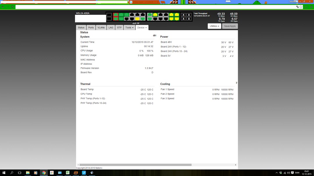

Have upload firmware 1.3.9rc7 in my SW24-A400 Pirate2 , either there is a bug in the firmware or so I have not read well enough in the forum :willy: . Here are 2 photos
i have upload to 11 other switch without problems :hurray: .

Re: v1.3.9rcX - BETA/Release Candidate
Sat Dec 12, 2015 12:39 am
I "think" your referring to missing meters?
I "think" that you installed on 11 other units with no issue would indicate not a bug plus i rolled out on all mine with no issue.
Try to refresh your browser or close and re-open.
If that fails try the upgrade again.
Mola9850
Posts: 78
Joined: Thu Feb 19, 2015 3:47 pm
Location: Denmark
Has thanked: 14 times
Been thanked: 14 times
Sat Dec 12, 2015 12:48 am
upgrade again fix it :cheers: ty. and ty for a super switch and fast firmware upgrade.

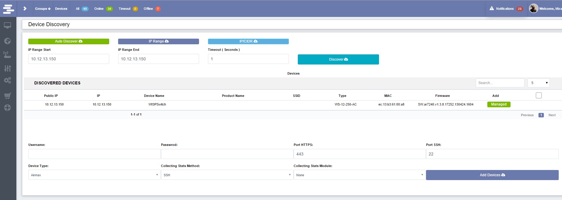

UBNT discovery is working on the 3 switches that I have upgraded. However, Host Name in Air Control is 'WISPSwitch', not the name that I have assigned to the switch. Is this just a bug, or am I missing something?
Netonix Discovery.jpg (151.21 KiB) Viewed 25560 times
Mike A - www.iwisp.gr

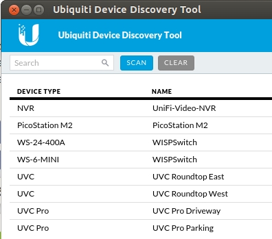

Sun Dec 13, 2015 4:42 pm
Yes, the Ubiquiti Device Discovery Tool confirms that NAME and DEVICE TYPE are reversed.
EDIT: Actually not reversed but not right either. The contents that in the Name field don't show at all.
Eric Stern
Posts: 532
Location: Toronto, Ontario
Been thanked: 130 times
Sun Dec 13, 2015 8:22 pm
I'll fix that in the next release.
