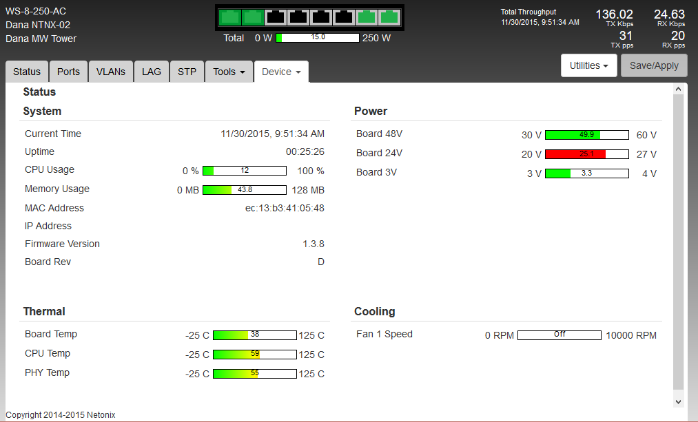

Upgraded five WS-8-250-AC switches to 1.3.8. They all went smoothly and appear to be performing well. With one exception:
It doesn't stay red, rather, it toggles back and forth between red and green. This device has two PowerBeam 650s plugged into it in Ports 1 and 2 (switch is providing POE to both) , a laptop in Port 7, and a daisy chain to another WS-8-250-AC in Port 8. The POE is off of course on the laptop and other Netonix switch.
I don't see where it's causing any issues, other than the red sure gets one's attention... :)
Thanks Chris
Sam

- Posts: 7634
- Been thanked: 1361 times
Re: v1.3.8 FINAL bug reports and comments
@SamgooberThis fine. It is because you have such a low load on the 24V, I suppose we need to increase the allowed range a smidge before it considers it out of range and makes it red.
We assume there would be a higher load on the 24V.
