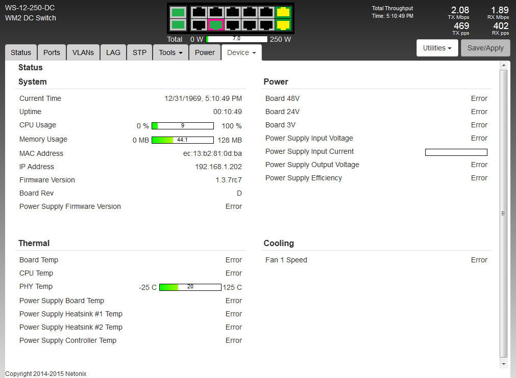

Not sure if you want the 1.3.7rc7 comments here, but here's some.
I upgraded a new install of a ws-12-250-dc to 1.3.7rc7 and all appeared fine. I made some config changes (NTP, Name, password) and after applying I receive errors on most of the sensor readings.
Port watts read -1.0 on all ports.
See screenshot below.

Re: v1.3.6 FINAL bug reports and comments
Sorry for your issue LRL.
Could you power cycle the unit and see if that corrects it? (remove power for 10 seconds)
We had another person who power cycled it and all was fine.
viewtopic.php?f=17&t=1172#p8758
We are still trying to figure out what causes this issue when upgrading.
If you do power cycle it and it fixes the errors please provide a screen grab of the Device Status Page without the errors.
Yea, that is what I have been doing for the past couple hours is trying to recreate this ERROR.
I have an idea to try and force an I2C error, will discuss with Dave when he gets back to his terminal.
Also hoping LRL power cycles it and let's us know if that fixes it for him, every little bit of information helps.
LRL - Did you look in the Log and see if there was an error reported in the switch Log?
