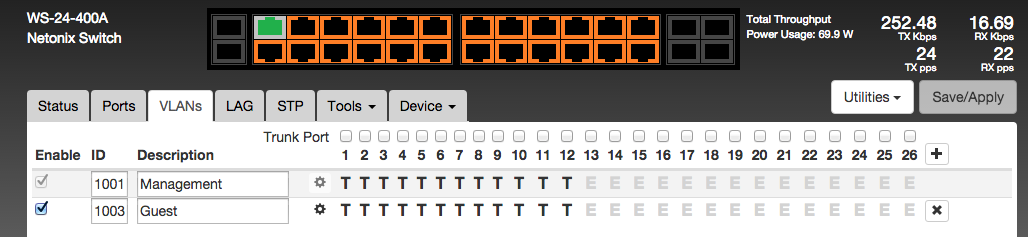

VLANs:

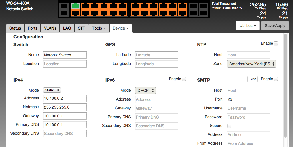

Configuration:

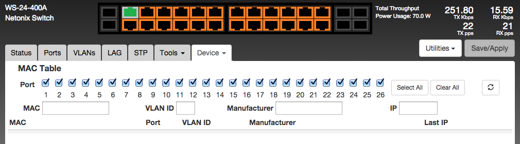

MAC Table before backup/restore:

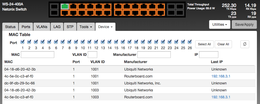

MAC Table after backup/restore:

jvince wrote:I have had problems with the MAC Table as well since upgrading from v1.3.2 to v1.3.3. When I go to the MAC table, there are no entries.
I reset my WS-24-400A to defaults and manually made my VLAN and configuration changes one at a time to see if a particular change caused the MAC table to break, but nothing did. I then backed up the config and uploaded it to my 2nd WS-24-400A, which had just been upgraded to v1.3.3 w/ default settings. The MAC table stopped functioning on the 2nd switch when I uploaded my config.
To test my theory that uploading a config somehow caused a problem with the MAC table, I uploaded the config onto the 1st switch; this should not have created any changes since the config was pulled from this switch a few minutes prior. After uploading the config, I no longer saw any entries in the MAC table.
I can't duplicate this either. If you could follow these steps and post the output it would be really helpful.
When the mac table is empty, open the console (Device tab -> Console) and enter the following commands:
- Code: Select all
cmd
cat /tmp/mac_ip.txt
cat /tmp/mactable.json
Mine looks like this: wrote:
Netonix Switch# cmd
BusyBox v1.19.4 (2015-08-14 15:50:44 EDT) built-in shell (ash)
admin@Netonix_Switch:/www# cat /tmp/mac_ip.txt
e0-3f-49-17-18-48 192.168.2.8
admin@Netonix_Switch:/www# cat /tmp/mactable.json
{ "MACTable": [
{ "MAC": "e0-3f-49-17-18-48", "Port": "1", "VLAN_ID": 1000, "Manufacturer": "ASUSTek COMPUTER INC.", "Last_IP": "192.168.2.8" }

Re: v1.3.3 FINAL bug reports and comments
- Code: Select all
cmd
cat /tmp/mac_ip.txt
Here is my output:
cat: can't open '/tmp/mac_ip.txt': No such file or directory
admin@Netonix_Switch:/www# cat/tmp/mactable.json
cat: can't open '/tmp/mactable.json': No such file or directory
Eric Stern - Employee
- Posts: 532
- Location: Toronto, Ontario
- Been thanked: 130 times
jvince wrote:Here is my output:
Ok, I found the problem. This will be fixed in 1.3.5.
Basically it is unable to show the mac table until it has learned at least 1 IP address. If you wait for a while and keep refreshing it will eventually work. This slipped in during the mac table optimizations made in 1.3.3.
