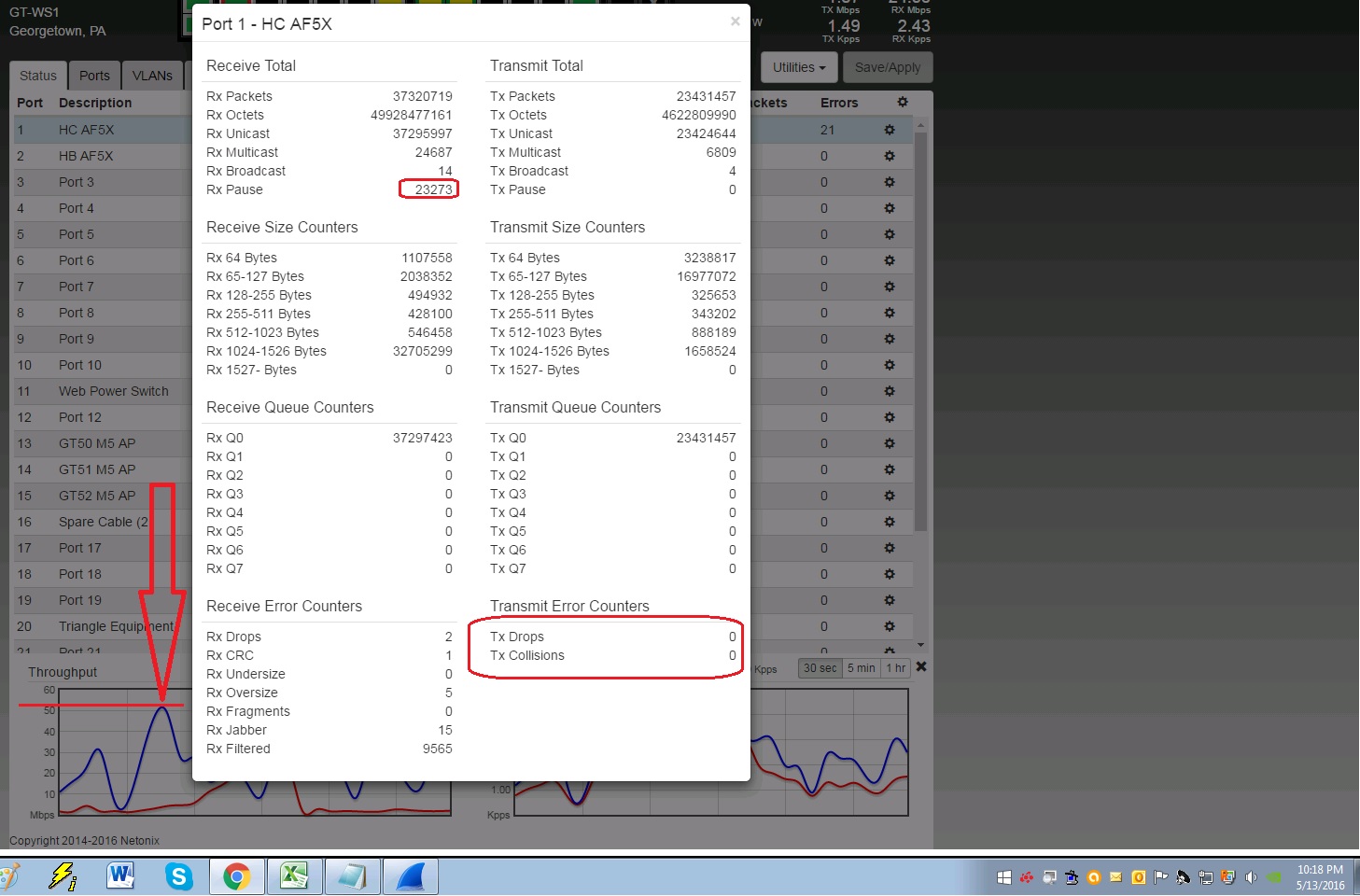

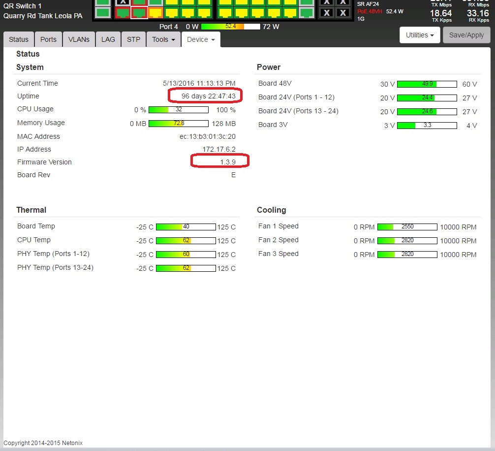

So tonight I was upgrading all my towers to v1.4.0rc22 and I was able to see the Pause Frame Storm happen for the first time but since my towers all have multiple paths in and out it recovered on its own which is maybe why I have never seen it as I just happened to catch this. Keep in mind this switch was just upgraded less than 30 minutes ago so that many pause frames is not normal in a short span of 30 minutes.
In this picture you can see the Pause Frame Storm occurred. Now this happened when another tower in the main ring was rebooting after the firmware upgrade and 1/3 to 1/2 of my network traffic would have suddenly been thrust upon the AF5X link when OSPF converged on this higher cost link with a lot of packets and data bursts higher than the AF5X link could easily handle as the bulk of my traffic normally travels across AF24 links.
CLICK IMAGE TO VIEW FULL SIZE

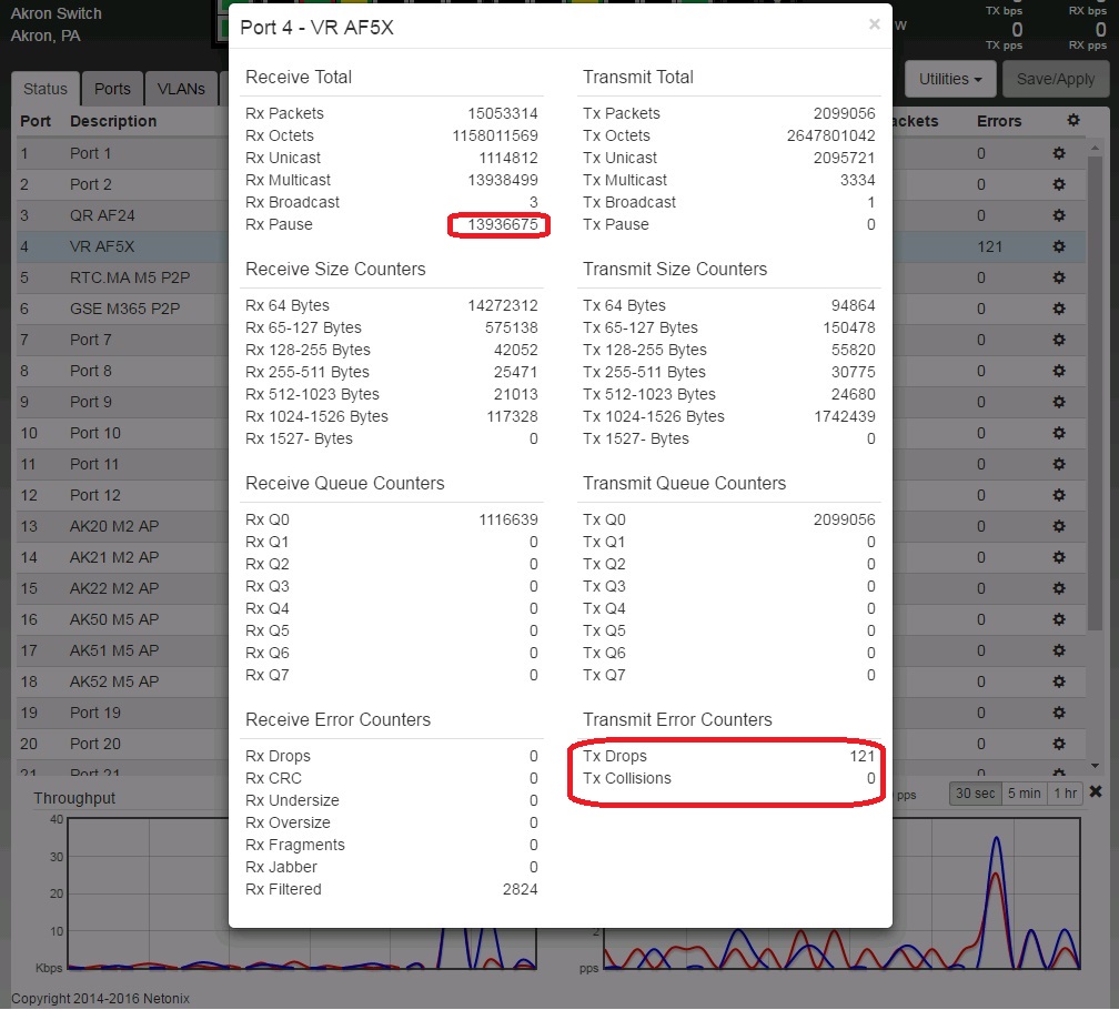

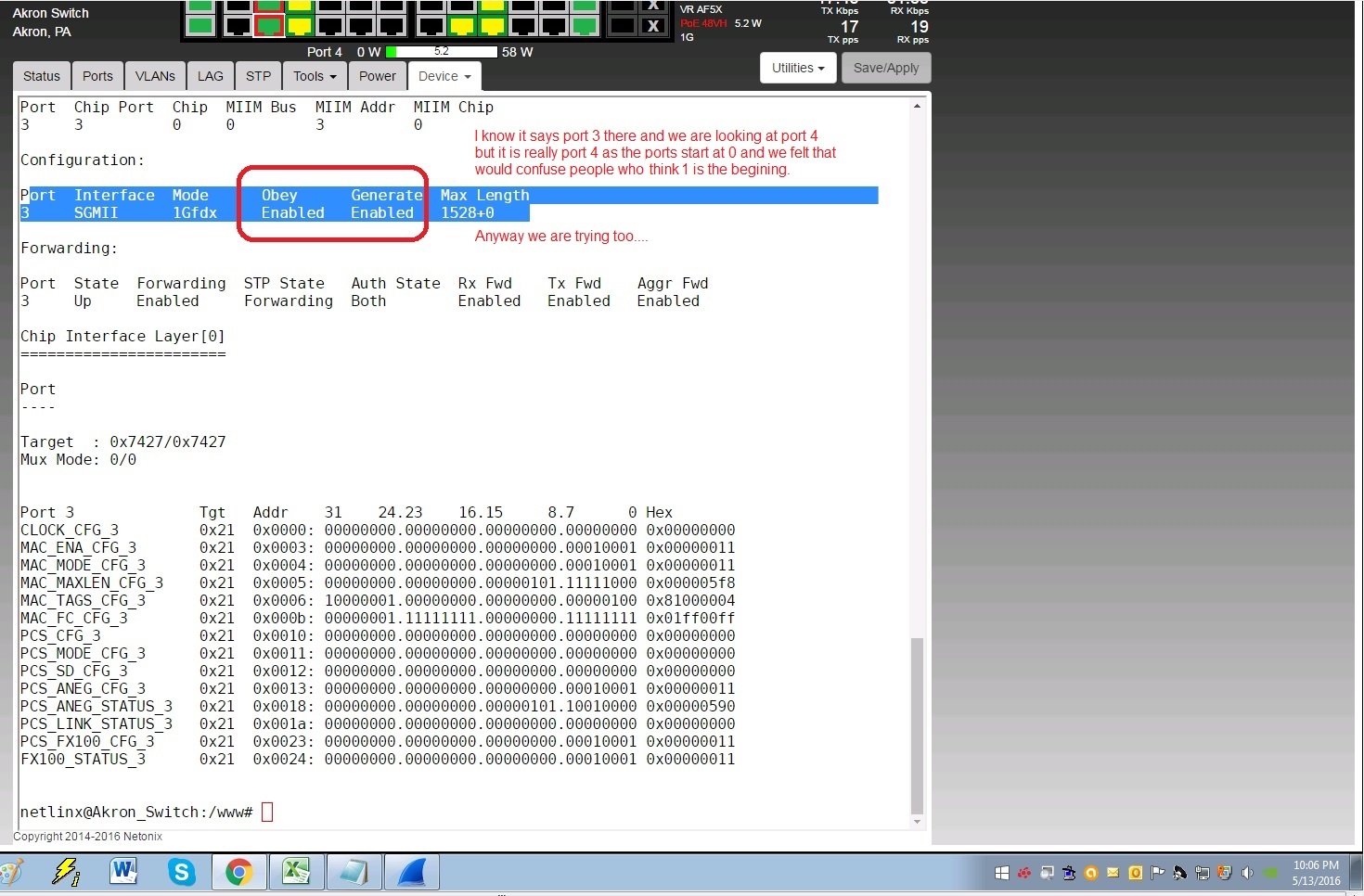

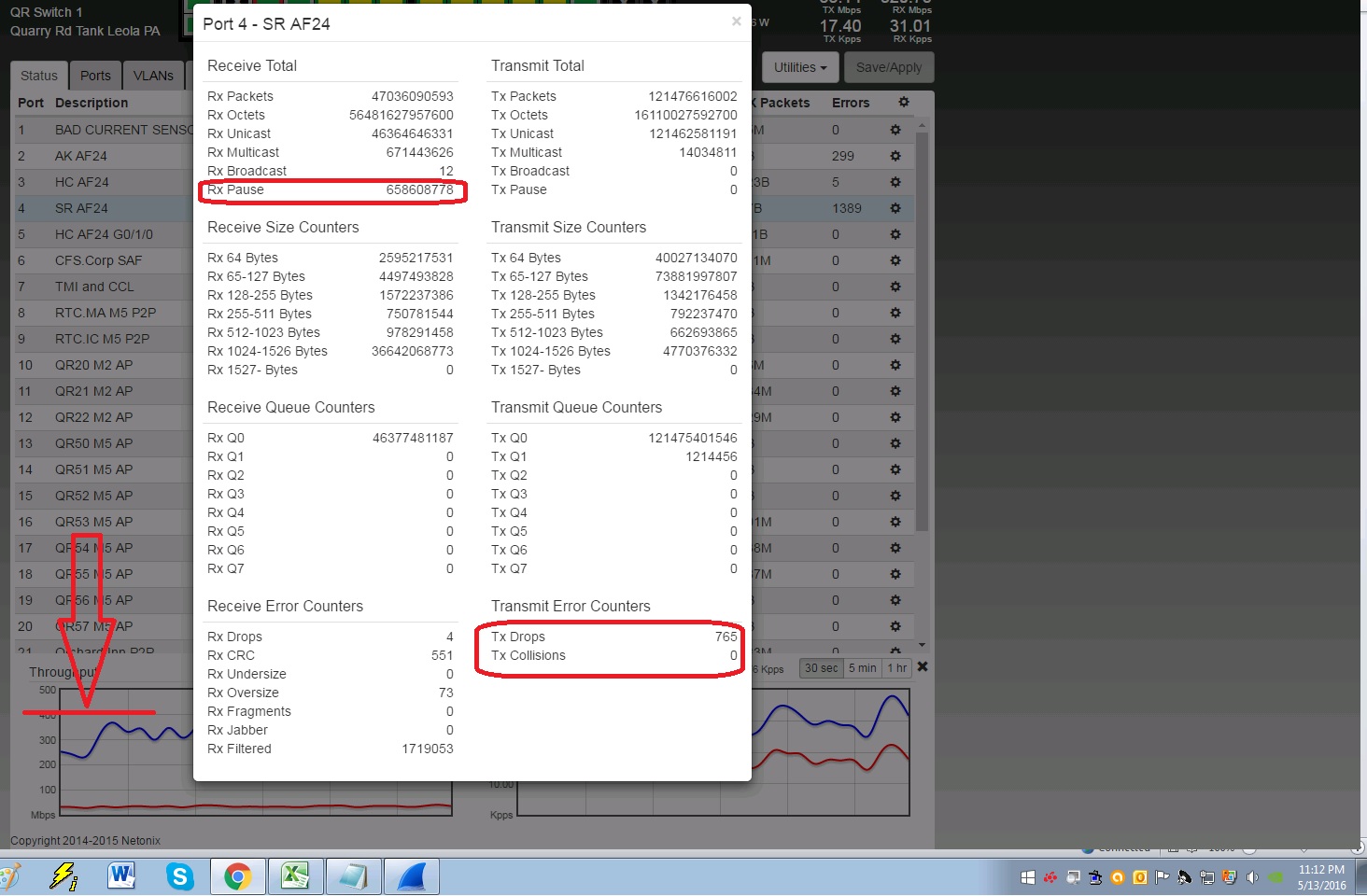

I saw the Tx Drops and thought about what Chuck had said about maybe the switch is not Obeying the Tx Pause Frames from the AF so we looked at the core to insure the port is indeed set to Obey and it was as seen in this picture.

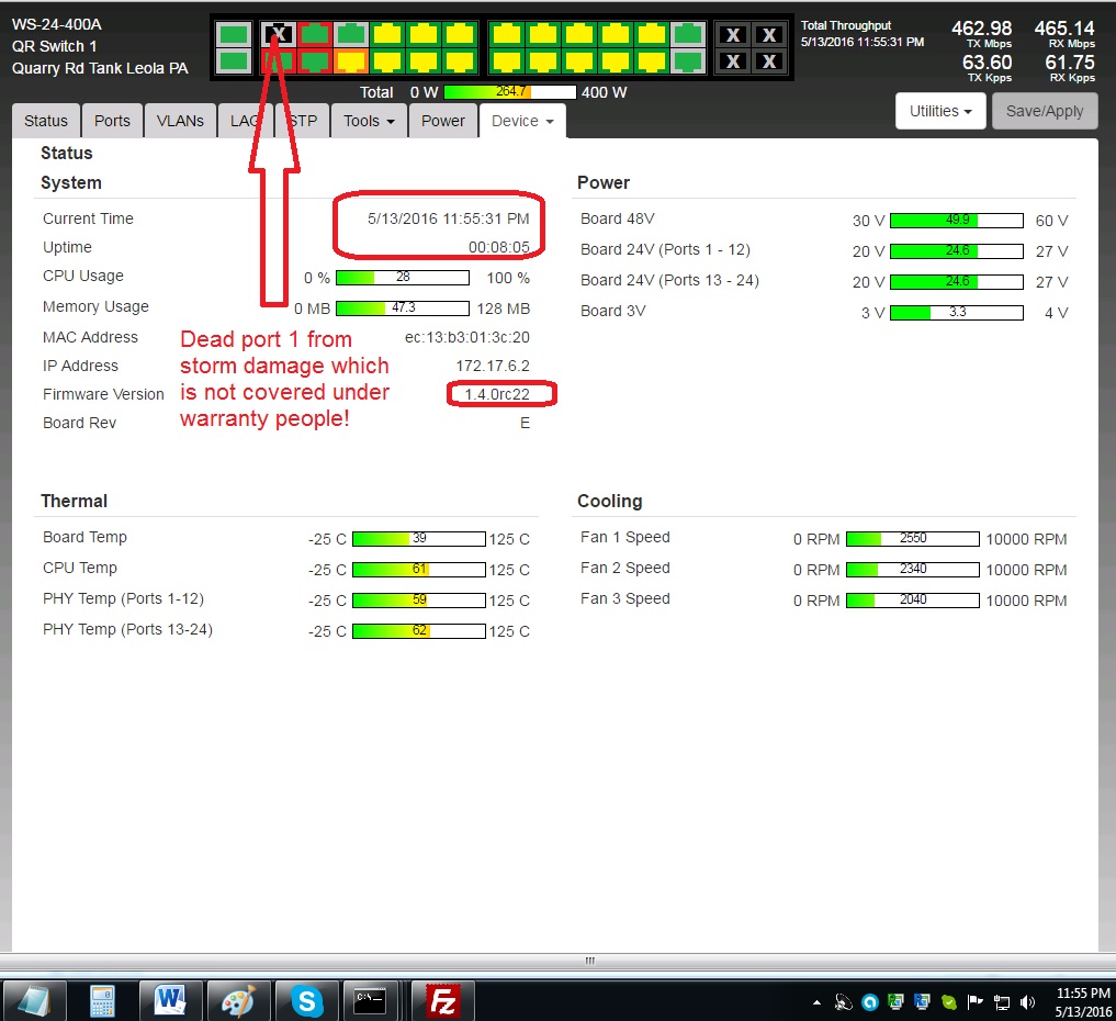

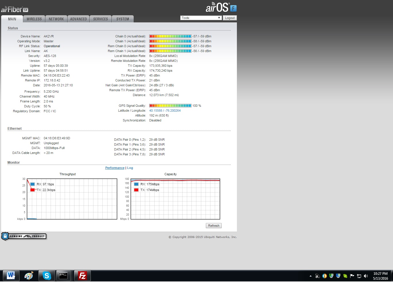

In this picture you can see the AF5X that appears to have generated the Pause Frame Storm but after the traffic had been moved back to the primary AF24 links. As you can see it is a SOLID link.

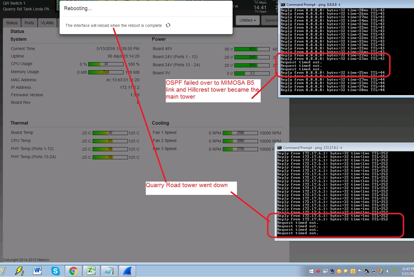

Now this picture is another switch in a side ring that goes out 10 miles into a rural area and the traffic never really pushes the AF5X link to the MAX and it is operating just fine and has never messed up.
So what does this all prove....nothing really, just another piece of the puzzle. But I think it may have something to do with an event when the AF link is saturated very fast with a ton of packets and a high amount of capacity possibly with a lot of data bursts of more than the link can handle easily? - ALL CONJECTURE AND NO FACTS
I do not know who is at fault but we are all trying to figure it out, Chuck and his team over at UBNT is trying and we are trying over here as well.
For now I think everyone needs to turn OFF Flow Control either on the AF radio or the switch port facing the AF radio "if" the link can be saturated. Now I was talking to Yahel tonight who found out about the KLUDGE FIX turning OFF his FLow Control with v1.4.0rc19 and he said he thinks he sees the Pause Frame storm with an AC 500mm PTP link?

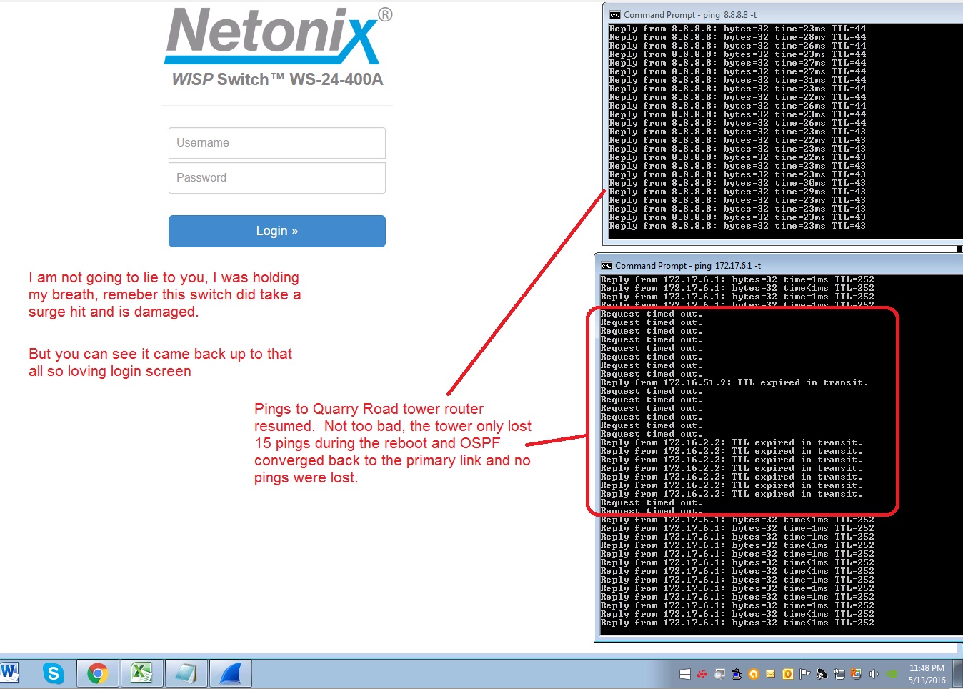

2nd Addendum to ISSUE update
OK so you can see in this picture I did the upgrade and the switch is rebooting. You can see that pings to Quarry Road tower stopped and pings to the internet missed 3 pings until OSPF converged on the backup link which is the MIMOSA B5 shooting into Hillcrest tower.
In this picture you can see the upgrade went fine and we are back to the switch login screen. I lost 15 pings to the tower during the reboot and OSPF converged back to Quarry Road Tower and no pings to the internet were lost.

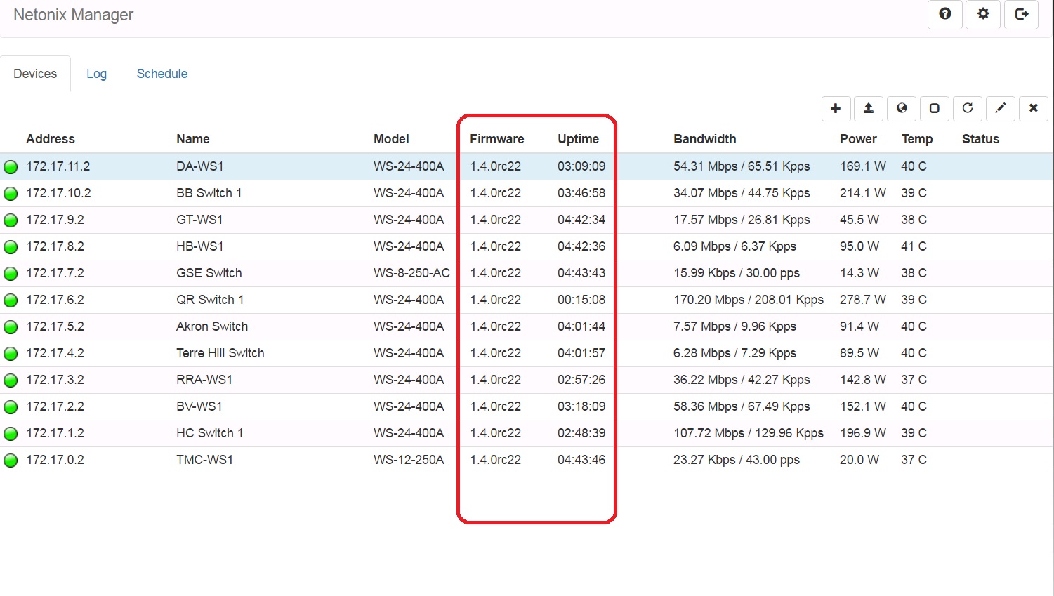

In this picture you can verify that my main tower is now running v1.4.0rc22
in this picture you can see I upgraded ALL my towers to v1.4.0rc22. I run the same switch and firmware you guys do and I always try it on my WISP first.
Personally I think v1.4.0rc22 is our BEST firmware yet!!!
