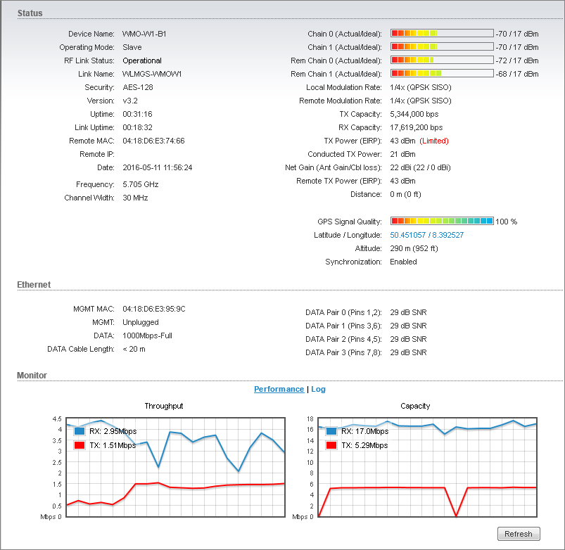

Another day, next AF5X and Netonix deployment - more weirdness that may be related:
At first the AF5X link was badly mis-aimed and it reported a distance of 0 meters too - never seen that before:

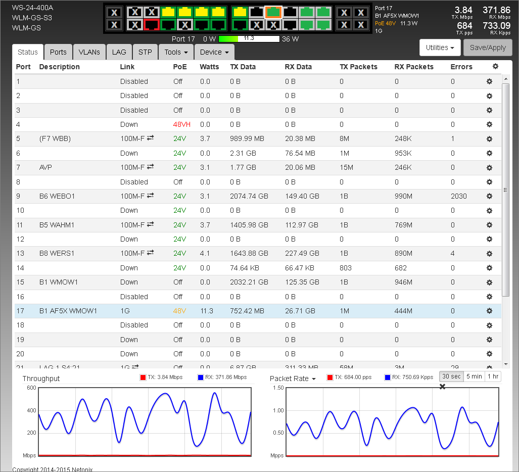

Having more traffic than capacity and because I had some time to spare today, I looked at the switch ports that the AF5X was connected to. This is the far end:
Note that the AF5X on port had been sending a whopping 600 Mbps into the switch. And note the packet rate of 1.25 Mpps! Of course, there was no real traffic as the capacity was only ~ 16 Mbps. I was able to connect through the link into the far end switch, though, and customers were getting 16 Mbps just fine.

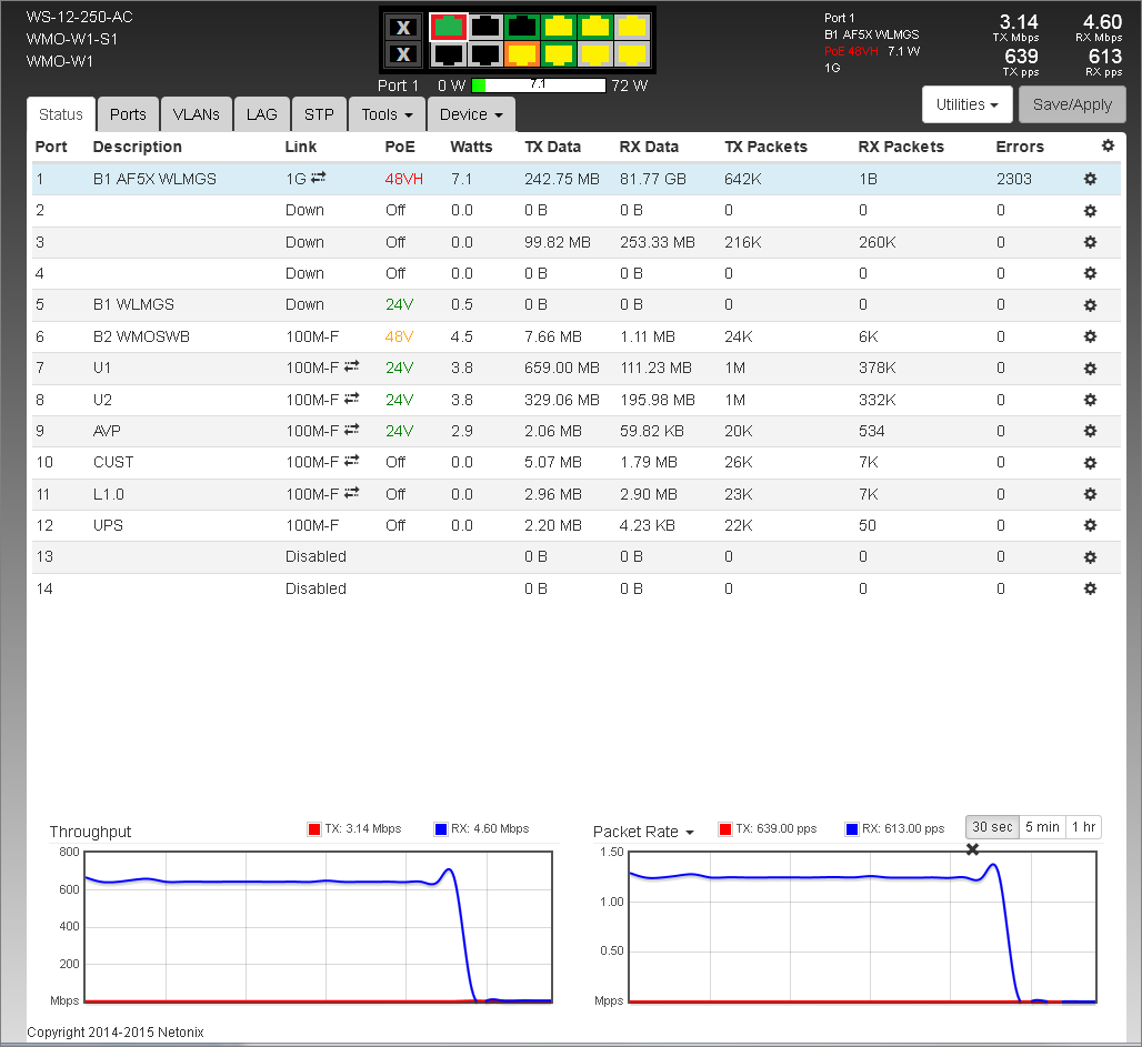

This one has been taken on the distribution tower (near end). Again, the AF5X on port 17 has been sending up to 550 Mbps, but fluctuating. The packet rate is up to 1 Mpps again.

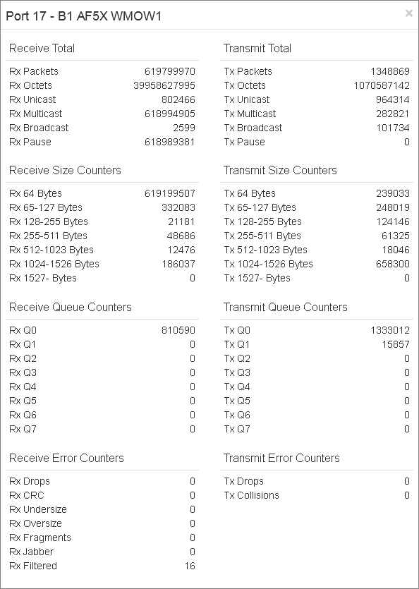

Port statistics show that most of this traffic sent into the switch must have been pause frames.
This confirms yesterdays observation: An AF(5X) will send flow control pause frames to the switch if there's more traffic than capacity. I wouldn't have thought it could be that much, though. In fact, there must be something severely wrong, even if we consider one FC packet for each data packet received: for ~ 6 Mbps of traffic, we should get less than 6 Mbps of FC frames. Or put it that way: It seems the AF answers each data packet with not only one FC pause frame, but a staccato.
However, this subsides as soon as traffic is less than capacity. In particular, I haven't seen the AF firing 8 Mbps constantly for no reason. So while this confirms that the AF has a bug with FC (which I will post on the UBNT forum too), the switches didn't lock up for a second. In a way, that's nice but it doesn't help to determine what makes the switch lock up when it does.
